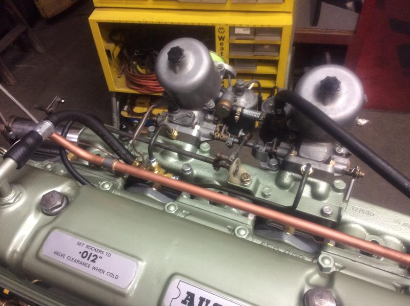

If you vent into the the manifold boss you will have to run your rear carb real rich to compensate for the extra air input. My engine builder came up with this:
He all but refused to install a rear seal, but with this setup my BJ8 doesn't lose oil through the rear of the crank.

Anybody that can accurately/uniformly bend tubing (I'm guessing PVC-covered copper?) is OK in my book.
attachment.php
That's an elegant solution, not calling out any undue attention by being so compact.
I think it's steel tubing but, actually, I never looked that close. The mechanic--Kevin--is a New Zealander who is extraordinarily meticulous; he's also a licensed A&P (Airframe & Powerplant; i.e. airplane mechanic). He got really excited when he saw 'Weslake' on the BN2 head we had him rebuild.

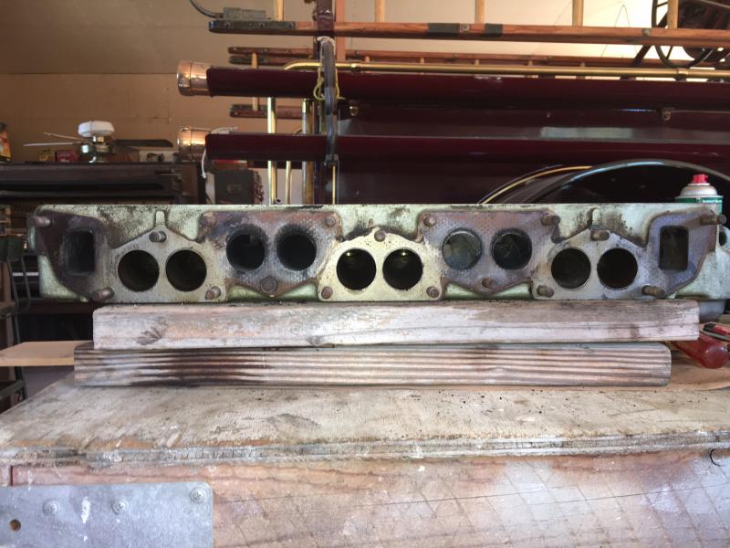

I ran with PCV valve into the rear port on the manifold for many years and miles, and expected a lot of gunk on the rear cylinders, but there really wasn't much:
I'm guessing using (mostly) 'top-tier-like' gas, with all the additives, may have helped.
