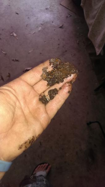

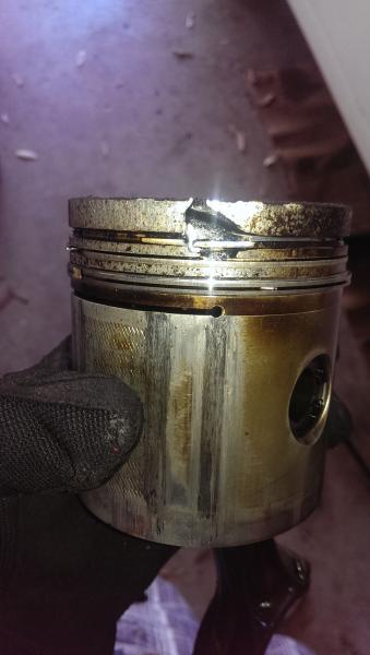

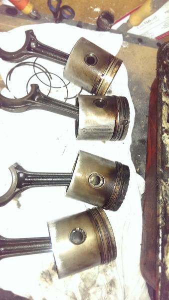

Check out the pistons and sleeves. I cannot believe this car ran as good as it did. the amount of sludge built up around the last piston (near the battery) was just crazy. 2 of the pistons were heavily damaged with all rings broken on both. These are definitely TOUGH little engines. Thanks for all of the advice that everyone sent me over the past two days! IMAG2247[1].jpgIMAG2248[1].jpgIMAG2254[1].jpgIMAG2252[1].jpg
