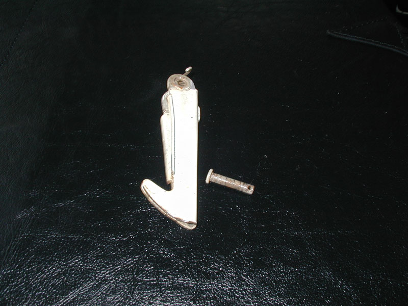

If the exterior has not faded too badly, and the engine compartment has not been repainted with a different color, you can use an easily removed item from under the bonnet for color matching. I pulled one cotter pin and removed the bonnet latch. It will likely need repainting anyway since it and the post/spring/cup quickly become scratched.
At least at my paint store they said they needed a large (maybe 8" x 8" or 10" x 10") relatively flat, shiny piece of metal to get a good paint match with their computer scanner.
