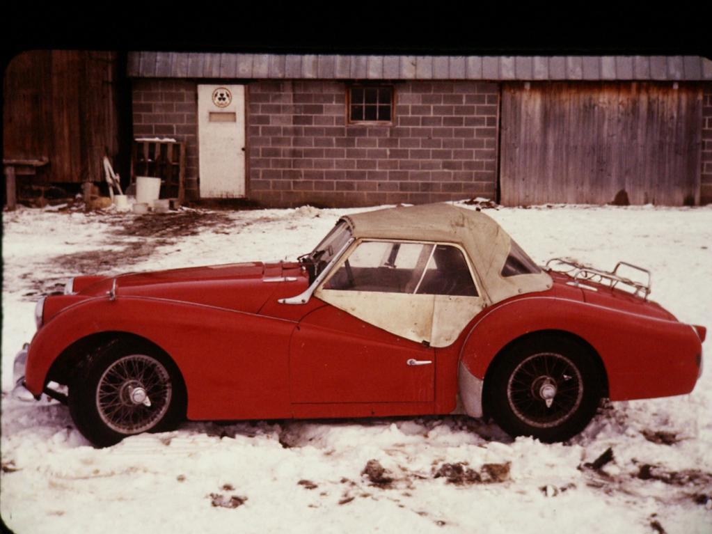

I did a Portland, Oregon / Champaign, Illinois trip middle of winter, 1971 in my 60 TR3. I "plumbed" in an additional heater from a 1950 Ford pick up truck. Same style as the Triumph but with a slightly bigger core and a much better blower motor. It went above my wife's feet on the passenger side. It was at least 10 degrees warmer on her side. You could actually feel the difference if you placed your right hand on her side of the car. PICT0013.jpgBy the way, I burned a valve shortly befor we got there and drove back to Portland on three cylinders. Gas mileage dropped to 13 or 14. Other than that, we made it home just fine. It's memories like these that keep me going on my 57. I hope I live ling enough to finish!
