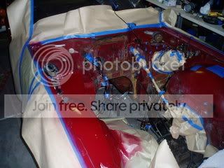

Parts all over the garage need to be cleaned,
rebagged and organized.
Car engine bay is being repainted, see photo below.
(Note by fear and trepidation, trying desperately to
paint without removing another thing. Reached max
capacity for dismantlement.) I laugh at myself now
and likely more later for this.
