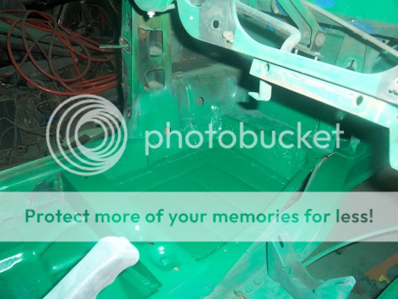

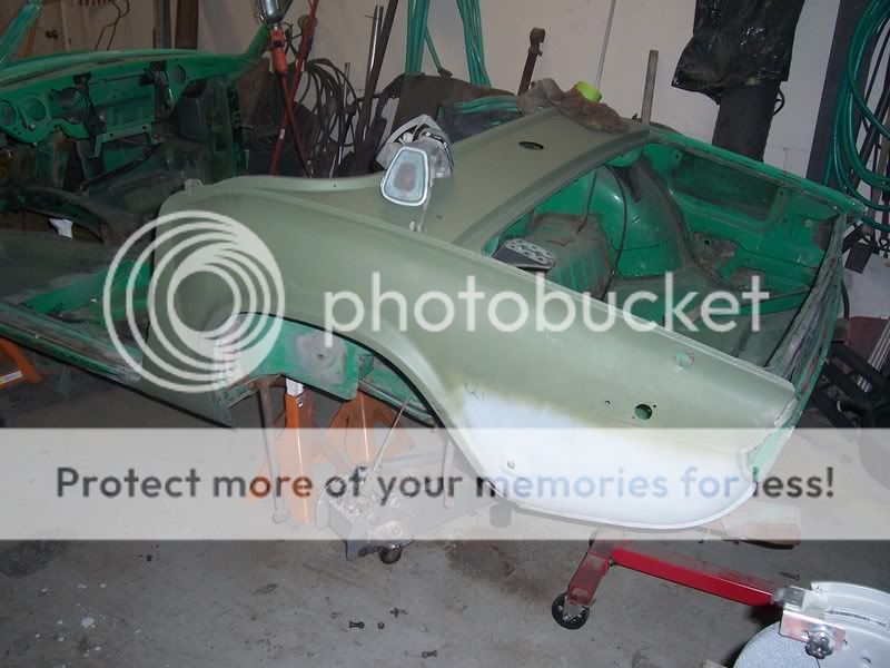

Good work. Before I was not jealous of the condition of your engine compartment. Now I am jealous of the condition of your engine compartment.

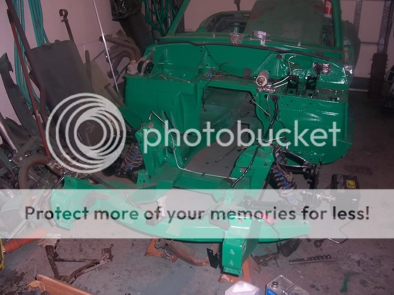

Update! I keep getting sidetracked on my weekend doing other non Spitfire prjects, such as installing a trans in a friends Jeep, lifting another, and fixing my brother's Jetta after he ripped the front bumper off... Anyhow, the front suspension is done and I have the wiring and brake lines back in;

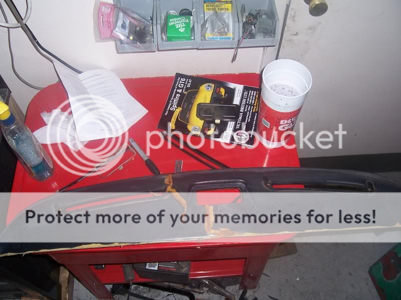

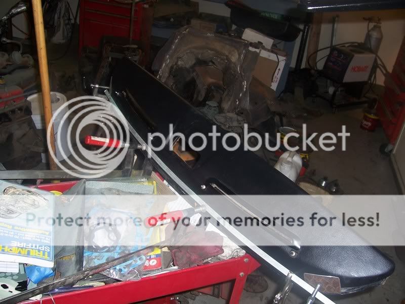

They even have zirks! Next up was one of those nifty dash pad covers. Best $50 I've spent so far on the car. Just trim, clean and stick.
Voila, new dash board!

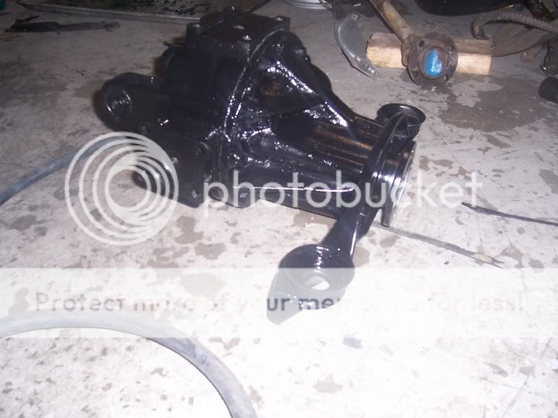

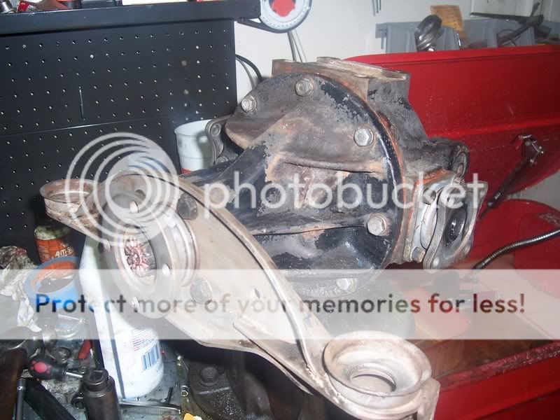

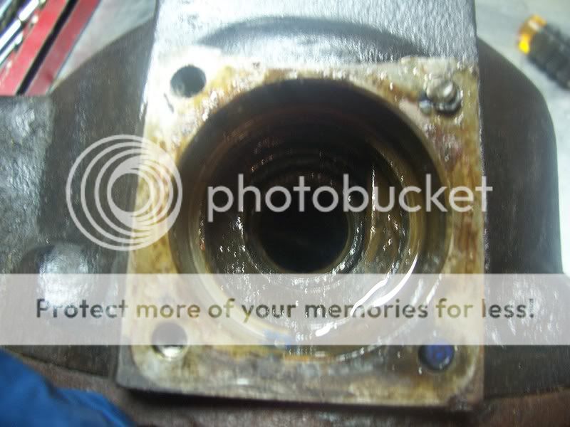

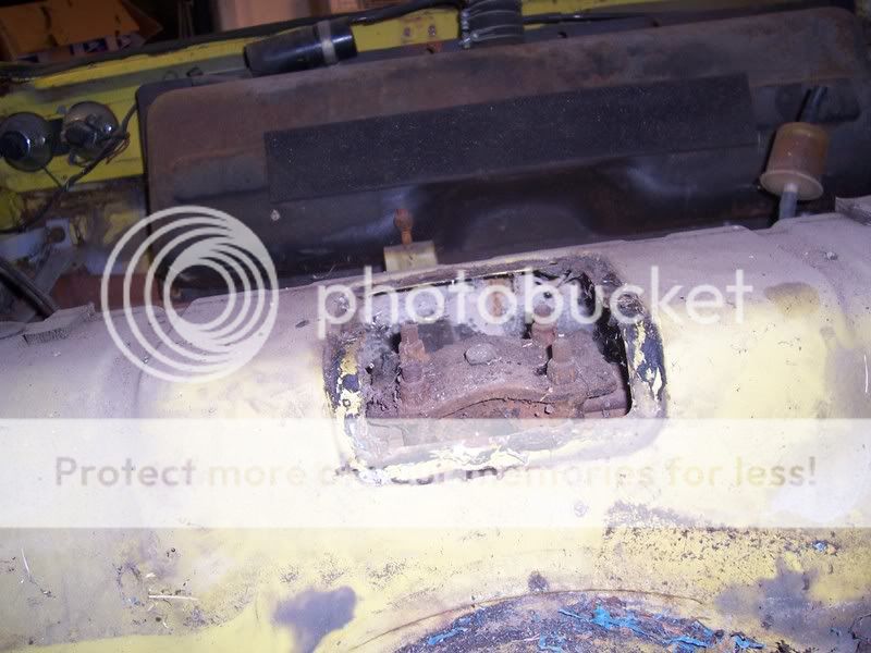

I will admit it didn't really fit the greatest around the defroster vents. I tried it on a couple of other dash pads and the allhad the same issues. I just gave it a good trimming. Next I was onto the diff. Made a rather crappy discovery, it was full of water!

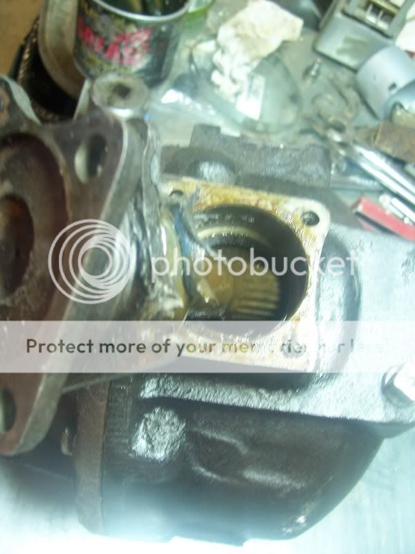

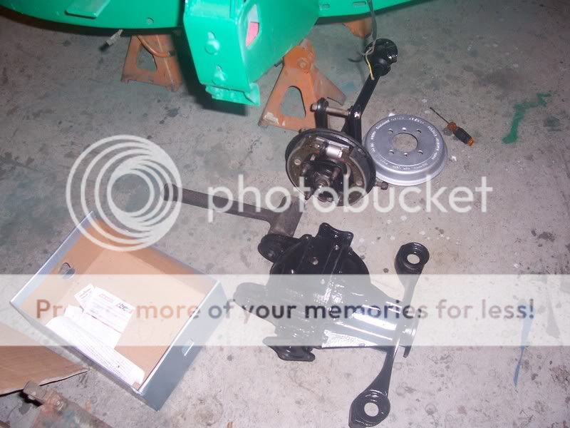

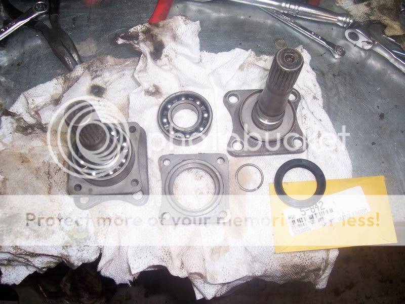

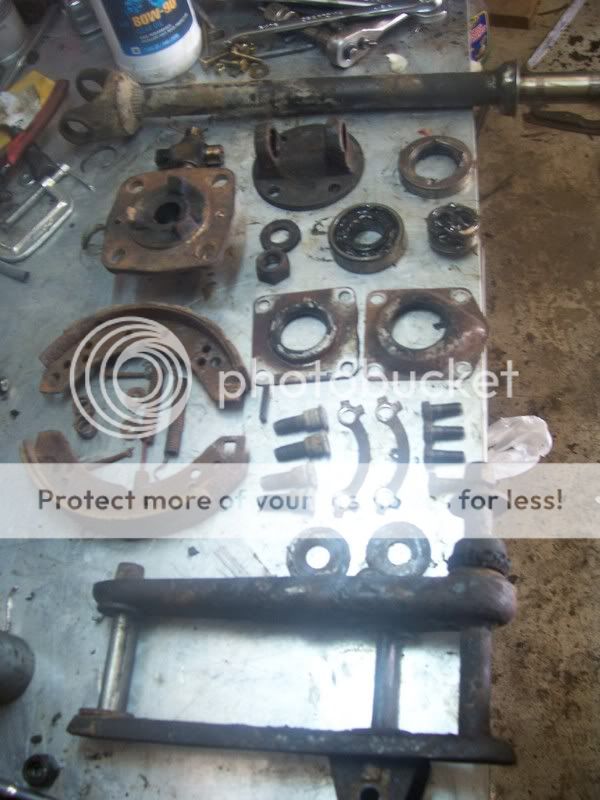

I guess that's what happens when they sit for years without a cover or spring studs installed... I wanted to use the original from the car but wound up using the one from the donor yellow car. Here's a few shots from replacing the seals. I wound up making yet another attachment for my puller to remove the bearings from the stub shafts.

frankenstang57 said:
...Next I was onto the diff. Made a rather crappy discovery, it was full of water!....
Been there, done that. And, thanks to cold winters here, I've even got one diff with a cracked case after filling up with water and then freezing! Needless to say it's of no further value....
Too bad about the diff, but if its not totally rusted out you should still be able to use the ring and pinion gears - or save them for a future diff rebuild.
I have had problems in the past finding those little spring steel circlips that hold the bearing in place on the stub axles. Did you find a place that sells them? Get some new ones in a kit? Or were you able to get the old ones off without bending them all out of shape?

Fortunatley the diff is not toast. There was a little bit of grease coating everything and for the most part it kept rust from forming. I would be very suspect if the bearings though. Dunno about the circlips, I re-used what I had. Where did you find yours? Gimme a couple days and I'll post detailed pictures of my homeade tool. No pat., just ripped off what I saw. Got the passenger side axle ripped apart today in about an hour. No struggling! Got everything blasted and painted and ready for assembly later today.(I work mids, so your today is my tommorrow...) /bcforum/images/%%GRAEMLIN_URL%%/smile.gif
I kind of thought the same - that is, the bearings I would not trust, nor the seals. But everything else should be salvageable, even if you have to de-rust it.
When I took my diff apart I didn't think about these and just ripped one of them out with pliers. Silly thing to do in hindsight. I could not find them at any of the 'big three'. TRF had them listed (part number is 139532) and even had a price (30 cents each) but does not stock them. I found two from a parts supplier in Montreal for $5.00 EACH. I expect you could make some, but I was pressed for time.

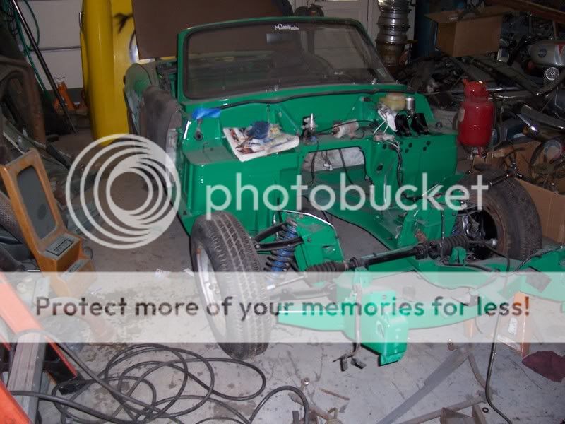

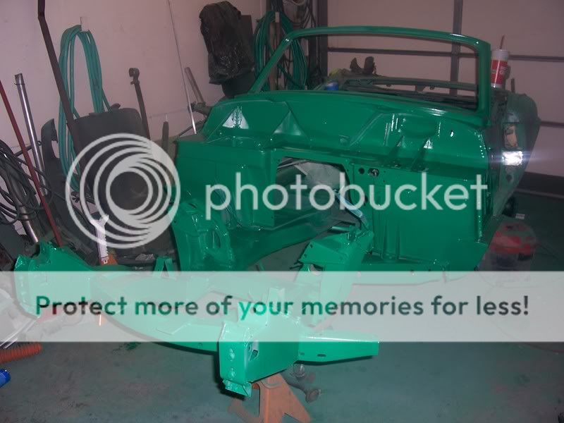

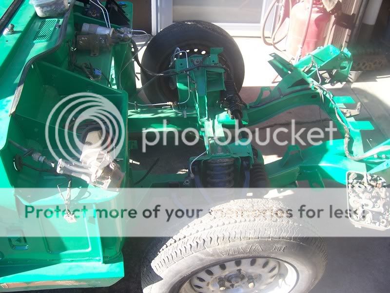

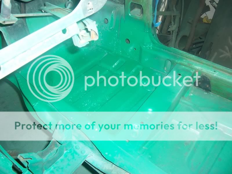

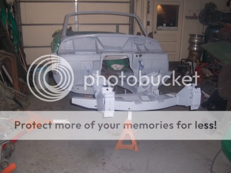

Got a few updates from the last couple of weeks! I finally have the Spit back on the ground, with real working suspension! I rolled it outside for the first time in nearly 6 months;

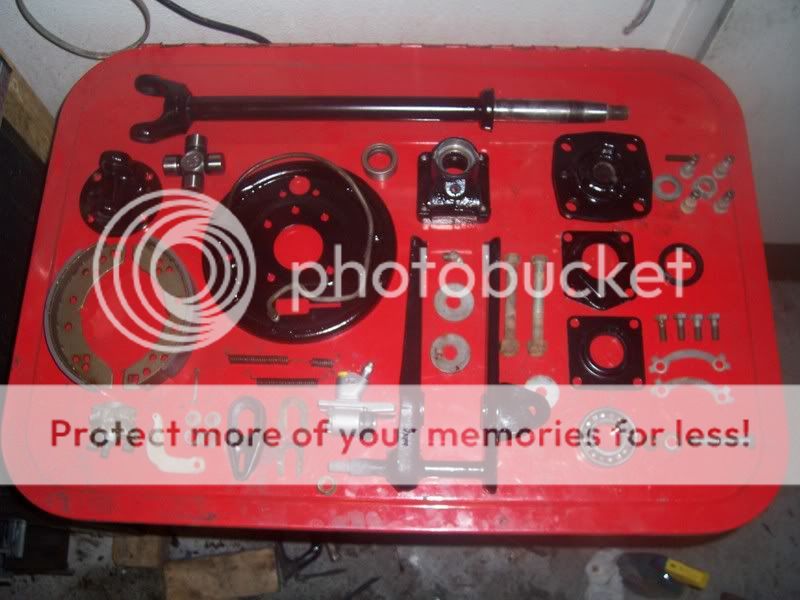

It's starting to look like a car again! Here's a before and after of the rear axle assembly;

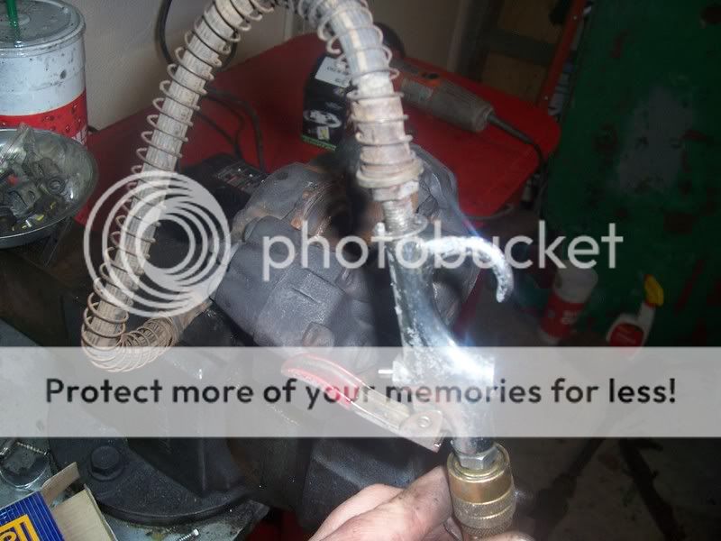

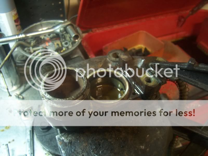

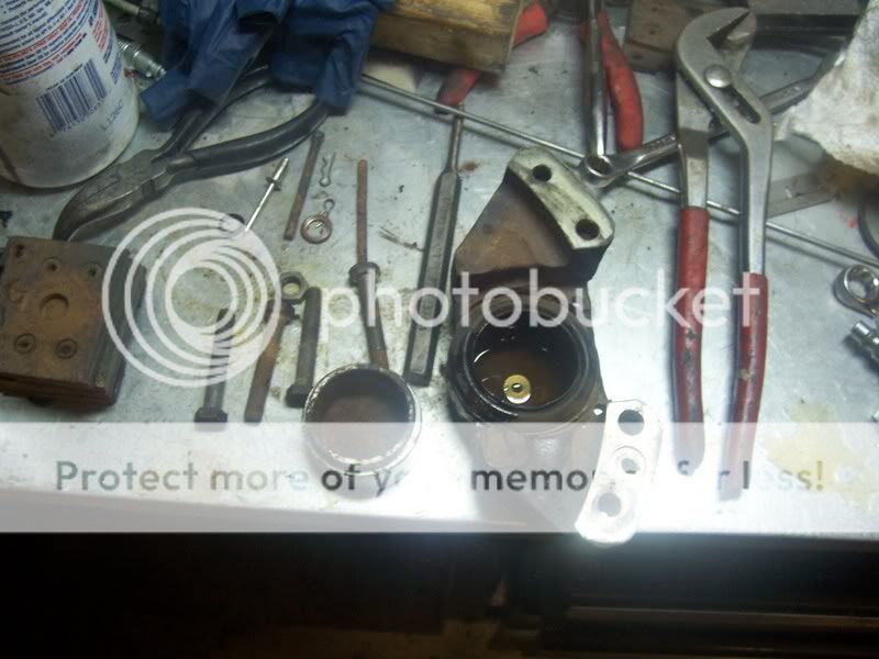

And a few from my adventures in rebuilding the front calipers;
I used air pressure to remove the pistons from the calipers. Just kinda easied them out, that is until I ran into a stuck one. I clamped the opposing piston and it still wouldn't budge. Needless to say, it got a little ugly about this time. I split the caliper, installed a clamp with a small piece of rubber over the balance hole, and hit with my shop air full on. After hitting it with air and then tapping on the piston, I nailed my 12' ceiling with the bugger!(bottom pic.) I'm sure there are better ways of doing this, but I didn't really see any other option that didn't involve destroying the piston. BTW, i'd like to thank bcliff for his time helping install the windshield. Fun couple hours that was!

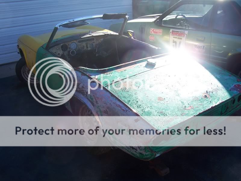

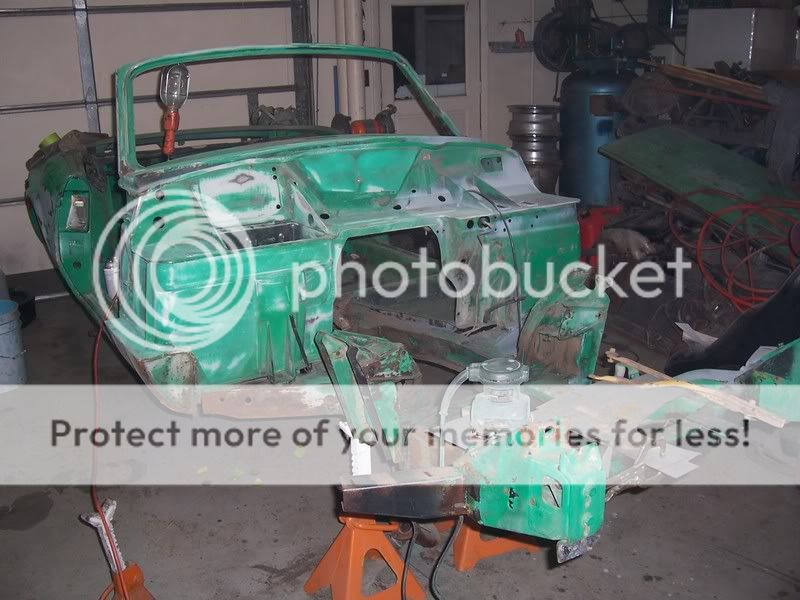

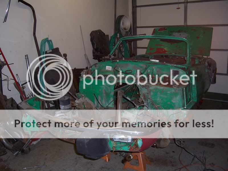

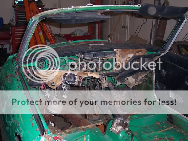

After long months and other projects it's back on! Also read, bcliff got his Junkpile B running first.:D https://www.britishcarforum.com/bcforum/ubbthreads.php/ubb/showflat/Number/380232/fpart/1 I guess it's time to get going on this again. the most comical thing so far has been the steering column. Some of you may have heard about my inheriting a truck load(literally) of parts from the guy I bought the Spit from originally. Couple that with the 2 other cars I parted out and I'm silly with Spitfire parts. So the aft most clamp on the column went missing. I figured I should have several. After about 6hrs of looking I now have a better knowledge of whats in all the boxes! No @#$%^%$# clamp tho. I found the bolts, nut, washers, lower clamp(several) but no sign of the allusive clamp. I finally said the heck with it and decided to make another just for now and track the proper one down online later. After modifying a lower I dropped it on the floor(it was pretty hot) and kicked it into the other room. Proud of myself for making my own clamp I put my welder away and proceeded into the other room to grab some pliers and grab my new part. What do you think it was laying next to on the floor? The missing one!/bcforum/images/%%GRAEMLIN_URL%%/lol.gif Oh well! Here's some updated pix;
More to follow!:smile:

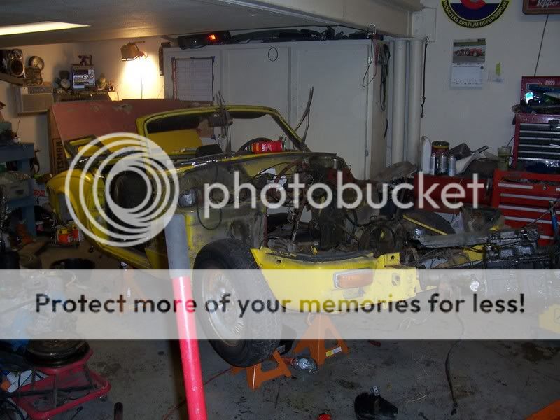

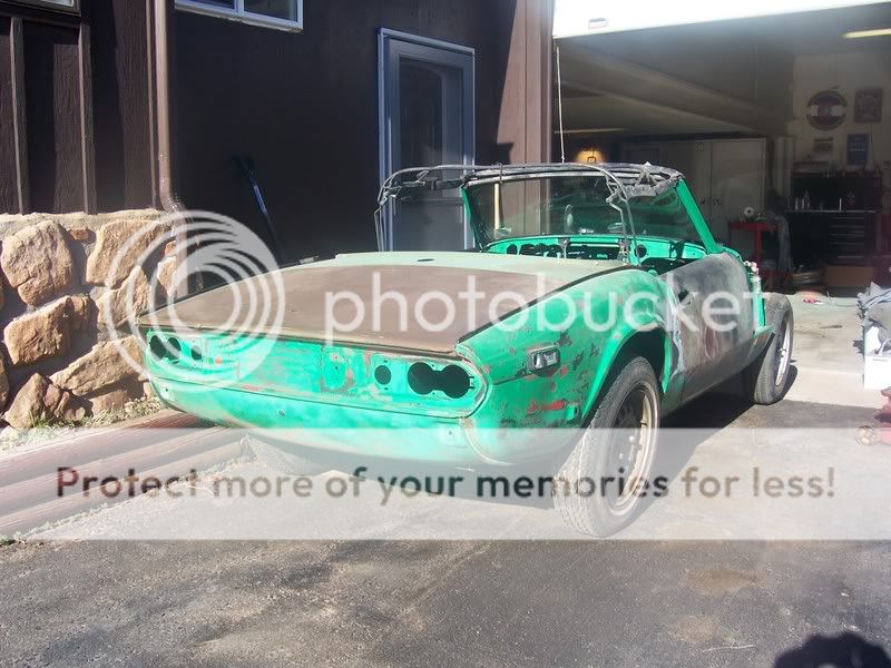

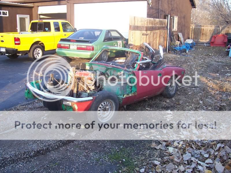

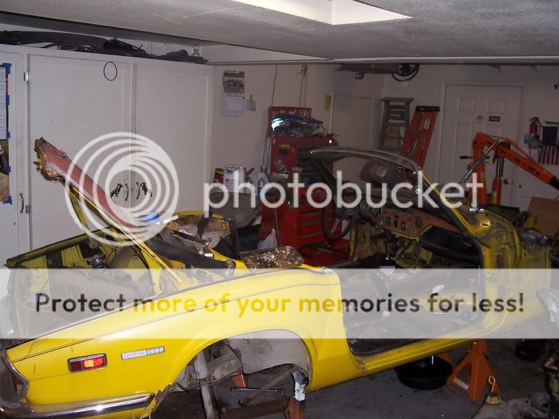

It's been a long time since this subject has been visited so I though I'd give you guys an update as to what happened to the Junkpile Spit! The last year, a photo history:

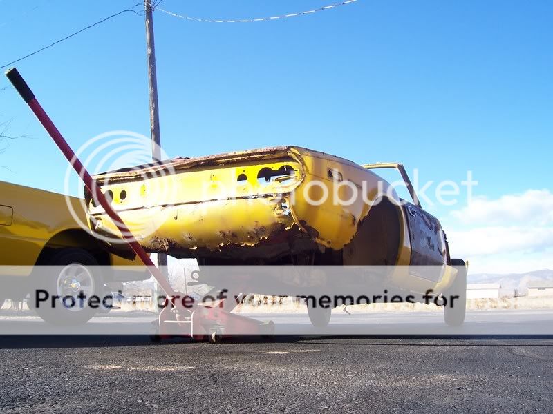

A guy showed up at my house offering me this:
But first I need to turn this into parts,
and turn this,
into this:

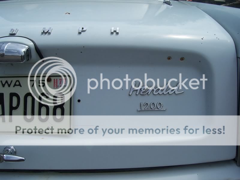

About a month earlier Phoebe arrived,
Did a bunch of work on the Corvette to make it go away. People make fun of British cars and their build quality, but this thing was a pile on par with a Yugo!
Didn't do enough of this,

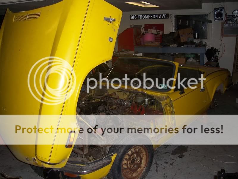

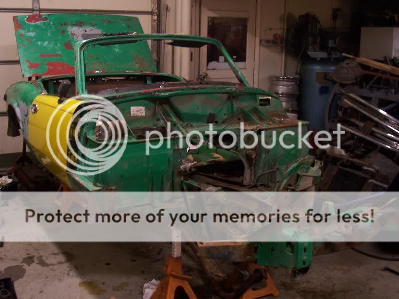

and bought this,

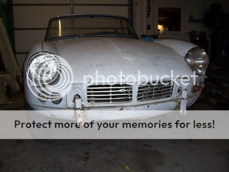

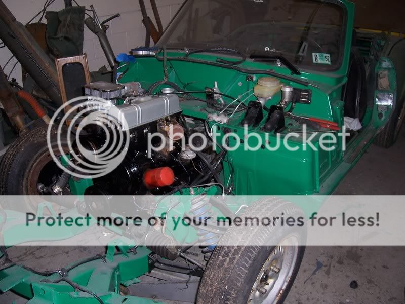

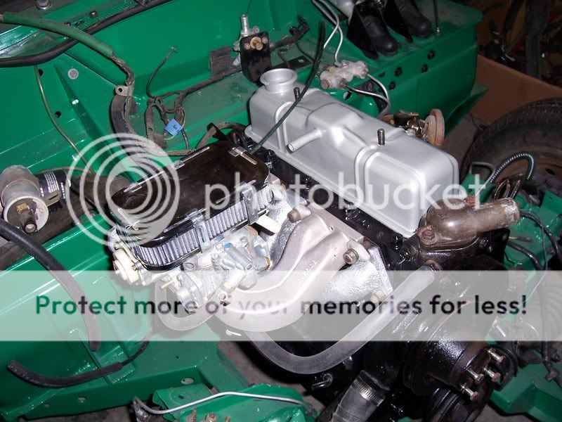

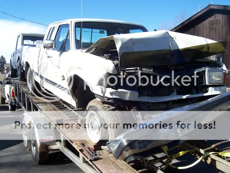

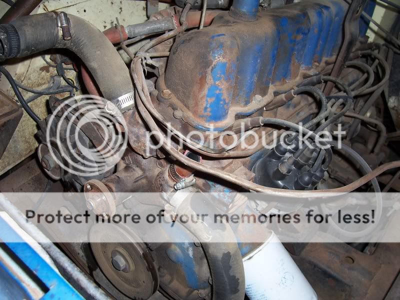

The new Spit is a '63. I'm planning on throwing the 1500 from the JPS into it and getting it going for spring.(the motor that was removed originally, it was infested with mud-daubers. I used the motor/trans from the MKIV I parted) The Bronco is nearly done. I swapped a 6cyl/3on the tree for a 302/auto combo. I also located all the parts and funded most of it with the proceeds received from parting out the F-150. That's alot of work for a stupid Herald! I will add it is a personal export model, has 31k original miles, and is 95% unmolested. I'm hoping to be back on the JPS hopefully by June, we'll see!
