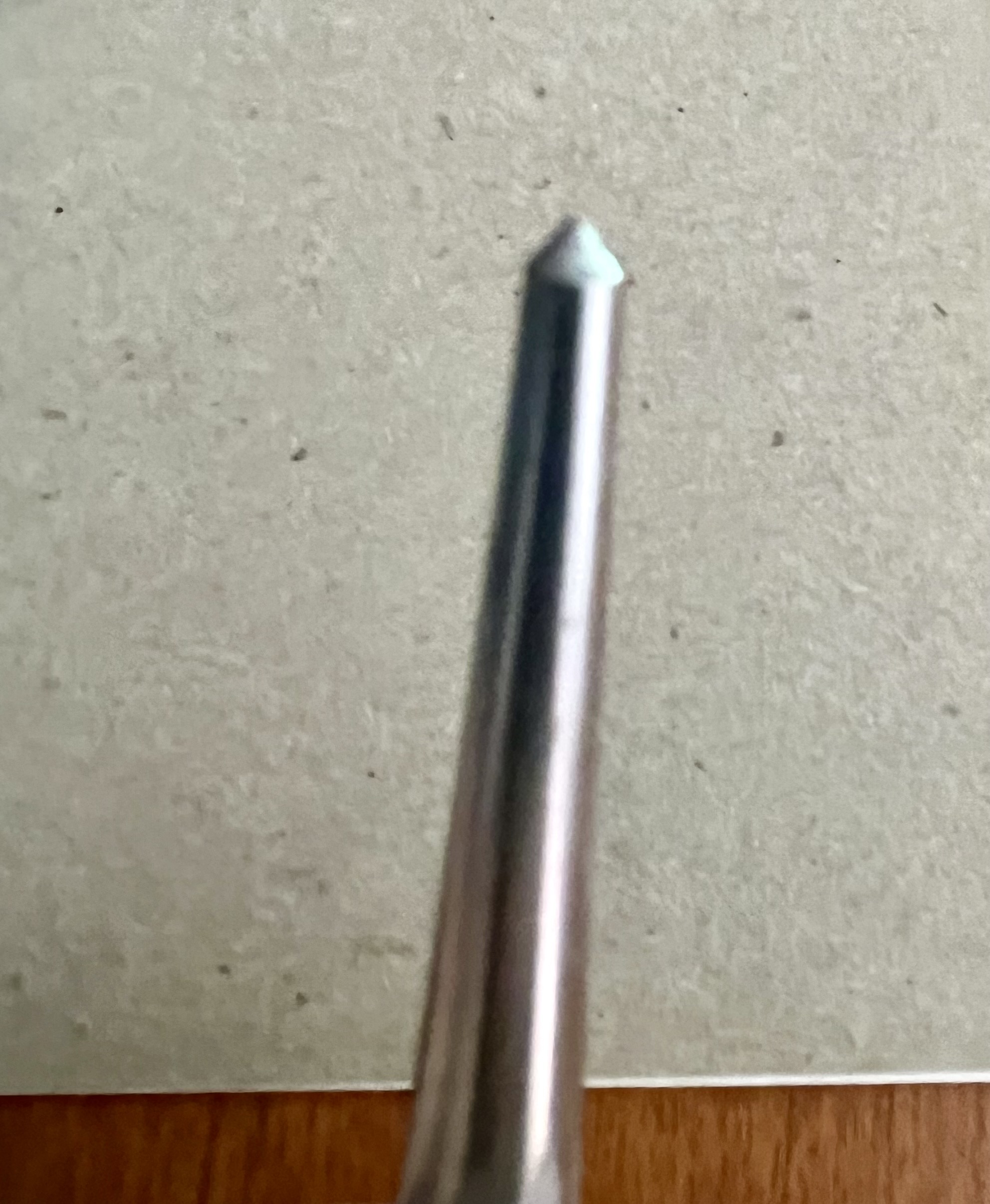

OK, Problem solved!
I used a hardened punch to spread the end of the pivot pin. It's not coming out now.
If I had this problem, I'd put a little tack weld on it. You don't need a welder; you just need a friend with one...
That was my very first thought. I don’t know anyone with one so this was plan B.
It appears to be holding pretty good.
A tack weld is the way it should have been manufactured!
