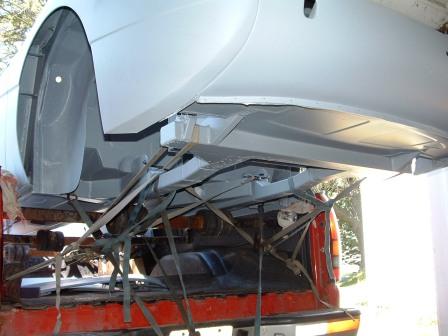

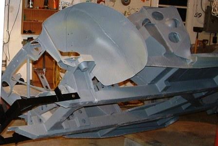

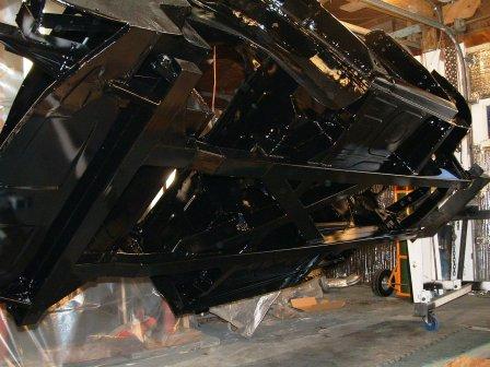

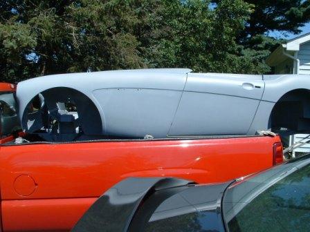

I'm far from the expert but if you haven't started yet go with all new. Jule or Kilmartin or other source, go with new. Call Martin Jensen. He'll talk you through it. Go see his shop and get the tour. As I recall it's about 90 min or so from Niagara Falls. I really enjoyed visiting with Martin and checking out his projects. We went to a restaurant for lunch and were still there at dinner time.
20th Side Road
Off the Guelf line
Rockwood, Ontario Canada
905-854-3555
Dale
