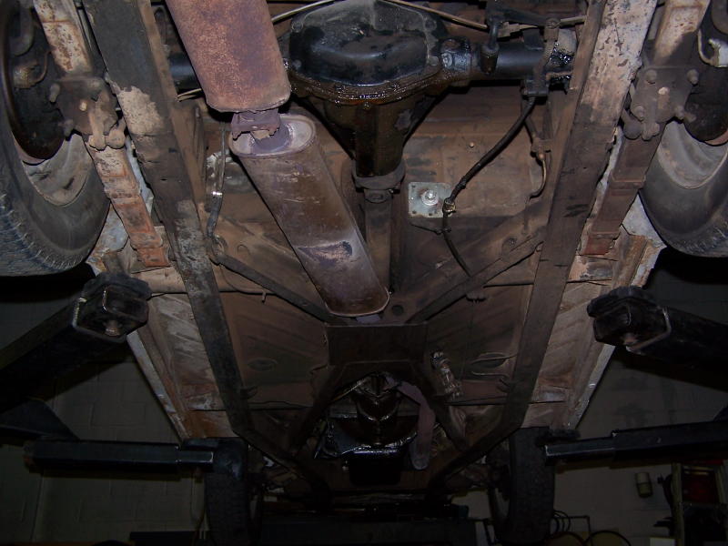

Talking of not lifting the car by the sills…
When I showed interest in my TR3A offered for sale by a well known clasic cars dealer in USA, and asked for more photos, I got among them the one I attach below.
This picture helped me deciding to buy the car … the sills and the floor couldn't be in a very bad condition….
JesĂşs
