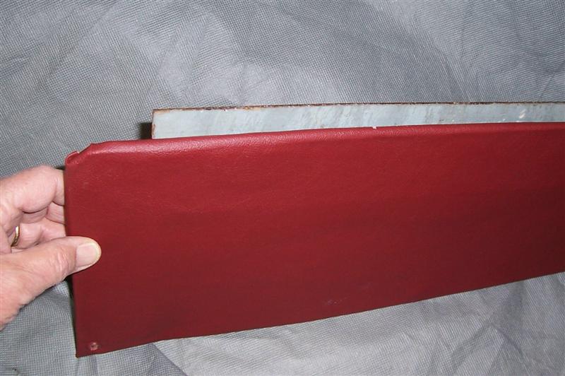

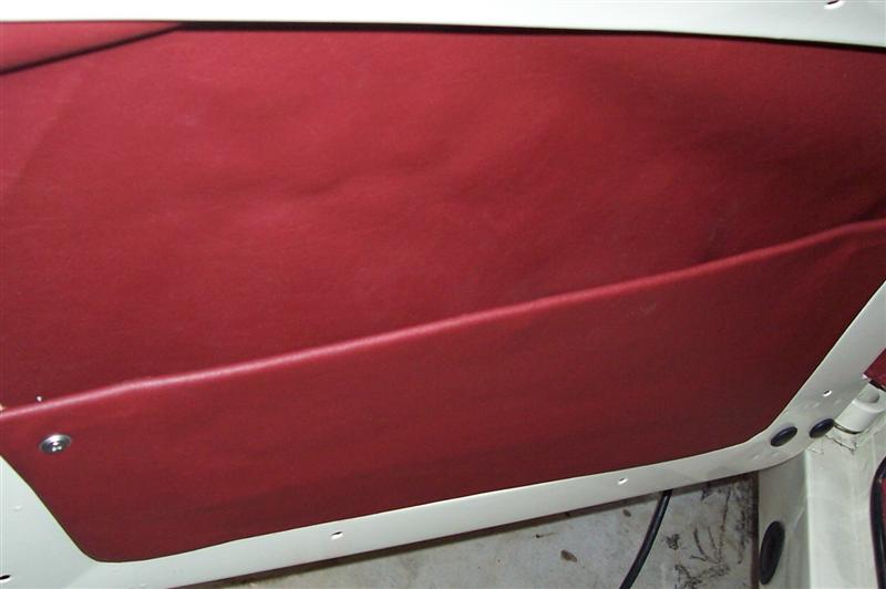

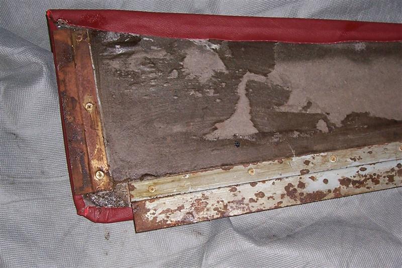

Sorry, I was confused. yep you have to cover the door pocket covers as well. However they are not near as nice as the orginals and are confusing to mount. The orginals mount with only two bolts at the tops and the sides and bottom have a metal peice riveted to the pannel which is bowed and also has a 1 inch by 1/8 inch peice surounding it so that the center sets in.
Let me take a pic tomorrow, I will pull one and inclued both sides etc etc.
This is a bit difficult to explain.
Do try to fine the orginal metal parts to hold it in, guess they could be made easly enough.
Any way Pics tomorrow.
Oh yea, Moss could not cover these because they need the metal parts riveted to them to hold them in place. No padding on orginals only hard cardboard stuff.

As requested pics of the inside door coverings.
Note that the stuff is very hard cardboard. Foot I did not get the last pic small enough you will have to click on it.
Arn't they awful close up.

Thanks for the pics Jack. I will have to figure out how to make those pieces. I bet I can use spacer material to make the lip as opposed to bending.... Will hav eto think about it.
When you attached your panels, did you use screw and flat washers or cup washers?
In fact I used one of each, both with cups on them, stainless of course. The rear is a bolt and nut and the front a screw just cause it worked in the orginal holes. I think the passanger side is both nuts and bolts with cups on them.
