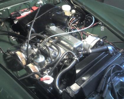

Well its been almost 2 years but the conversion to dual 1.5 HS's on my "77 Midget is complete and she breathed to life Sunday afternoon. I spent most of the day looking for leaks, tightening and adjusting.
I have a question for folks with the dual HS4 setup, they just don't seem to want to return to idle. I re-bushed and replaced the throttle shafts on a lathe and honed them correctly during the rebuild. I added another spring on the cable and I am wondering if I need another from the exhaust manifold to the linkage between the carbs? I took a bunch of photos of a Midget 1500 with the HS4's but I don't see any springs there.

That is one nice looking engine bay there!
Will she come back down to idle when you move the throttle shaft manually?
Thanks, it sure seems like it took forever to get here.
Yes, when I push them down. I oiled shafts a bit and it seemed to loosen them up a bit for a short time. I have only put about 4 miles on our dead end street.
Are you sure the cable isn't binding?
Ahh, had the same prob with my H1s. Solution was to polish the throtle shafts really well so the choke would not stick open just that little bit.
Not sure if that is your prob or not. See if the chokes can be pushed up at the throttle shaft at all. Prob only one that is sticking if at all.
Let me know, I love being right, LOL.
The cable is running pretty free, I'll give it a shot of cable lube form my dirt bike days. When I rebuilt the carbs I reamed and then polished the shafts with some oil applied. I could spin them easily before I assembled them.
But the chokes... I need to take a close look at them, also one of the guys at work said that since I haven't finished getting the mixture and settings correct I shouldn't be to "hung up" on the linkage yet, he kills me.
The saga continues this weekend.

YAHOOOOOO Last night I looked over the linkage and the fast idle cam screw was way to far out, (you were right Jack!) so idle issue fixed! I'm running ABT needles and ended up at 14 flats. Stock exhaust manifold, two blown out glass packs and no cat. You can see the filters above. I will get the inspection done tomorrow and then the tags.
