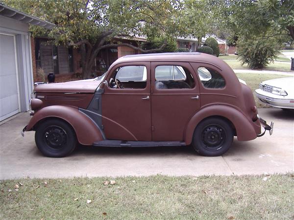

Got any photos?

Here it is in primer.

gotta say it - cute! :grin:
That's the sad truth Mark. There are only a handfull known to exist this side of the pond that haven't been turned. The other side, of course, they have mostly rusted away. Thanks to the internet, I have nearly all the bits needed to make a complete car. When you have some time to waste, check my web page for the whole story of the car https://enfoprefect.org.
That's going to be a real nice car when you get it done! :encouragement: It's a shame a lot of them were chopped up for hot rods, but back then very few thought of preserving them for future generations. Nice that your preserving it. Keep us posted on the progress. PJ

Very cool, it's good to see progress being made. Makes me want to go out and work on my cars.
