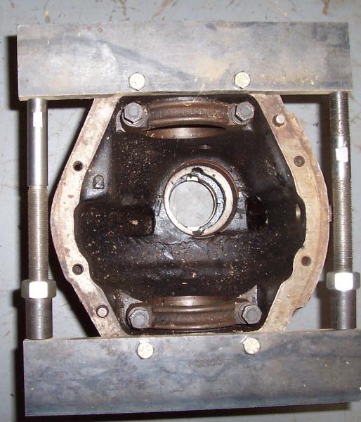

PS, building a spreader tool might be worth the effort; but it definitely is not required. A couple of big pry bars will scoot it right out

Here is a homemade spreader, if you decide to go that route- 000_1371.jpg000_1371.jpg
