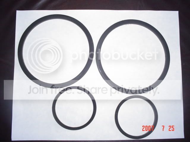

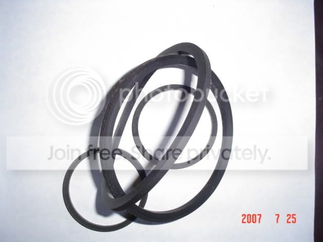

I have these. The large ones fit da 3. Not sure if they fit the gauges on a 6? If you want them PM me with your address. The large ones are 4.25 ID - 4.50 OD. 1/4 inch thick. The wee ones are 2 & 7/16ths ID by 2 & 10/16ths OD. 3/16ths thick. This is all I have for now until the next 400 hours or winter arrives.
