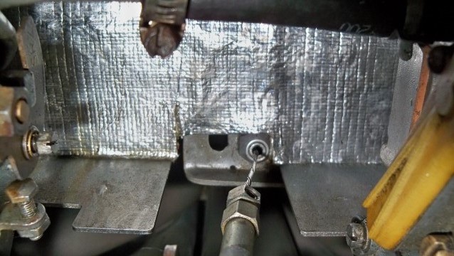

I will be interested in your resolution here, as I have the same issue with my 74 TR6. I have installed the heat shield from TRF, and my fuel pump is fairly new. My car starts fine, idles fine, and runs fine from a cold start. Also operating temperature is normal. However, after driving the car for a while, if I turn off the engine and try to restart within 15 or 20 minutes, temp gauge is it 3/4, car is hard to start, and runs rough, or cuts out. All goes back to normal, temperature, and engine performance, after driving for a few minutes.
That sounds like fuel percolation. The heat shield alone didn't do much to cure the problem...but when I lined the floor of the heat shield (top and bottom) with a couple of layers of "heat insulation" that cured it.
https://www.jegs.com/i/Thermo-Tec/893/13575/10002/-1
