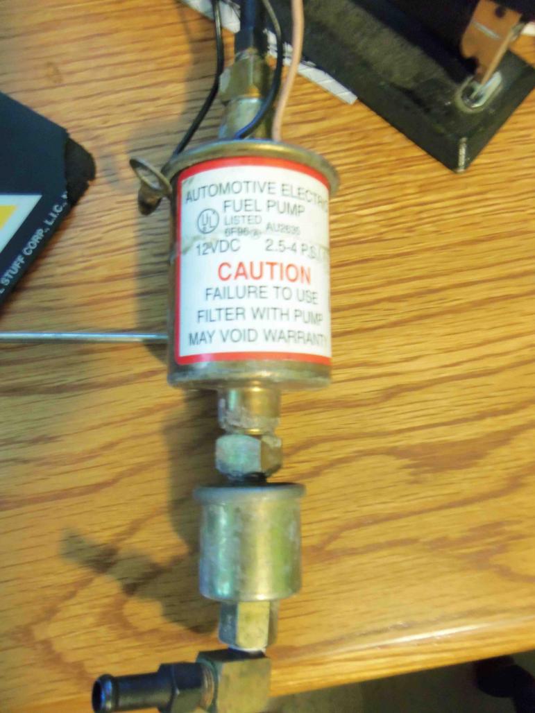

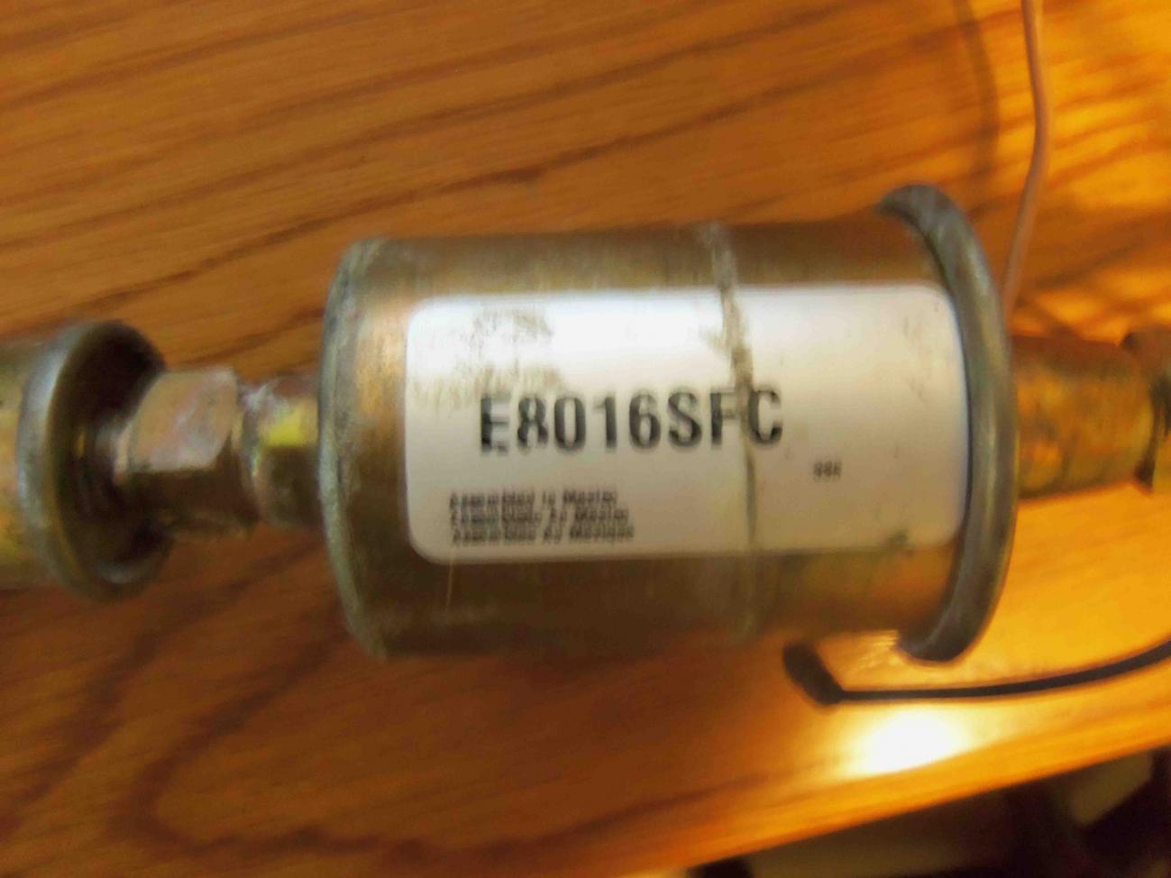

I had a E pump i bought for my TR250 from Car Quest. Our local TR mechanic recommended it to me. My concern was the noise too, however assured me it was very quiet. He said he puts them in a lot of MGBs because it looks OE and has that light tick sound to it. The cost was reasonable too. It is off the car now and I'll look for it and get the numbers and pic of it.
As I promised last week this is the pump I used for a couple of years. I recently took it off because I wasn't getting fuel to the carbs and bought a mechanical pump then discovered my tank was plugged. I will put it back on soon.

This one I listed is 2.5 to 4 PSI. perfict pressures. like I said I ran it for years on my 250 with tri carb set up. Seems to me I paid in the $40 doaller range back in 08.
