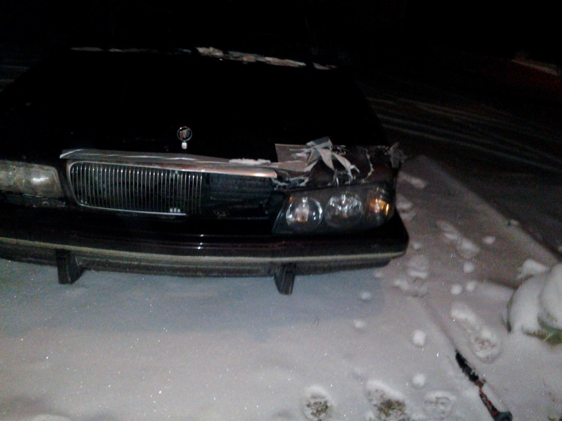

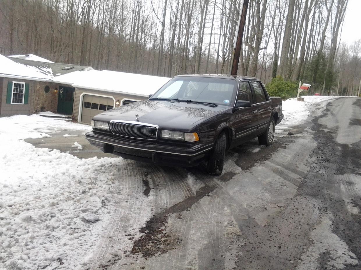

1130131408.jpg0103141925.jpgbefore and after on the Buick
