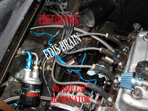

A small success today was firing the engine on the EDIS setup. Gone are the days of points, distributors, static timing, bad condensors, etc., etc.
Hello to a new world of endless good times! (pun intended! :wink: )
Right now I just started it in "limp-home mode" with the straight 10 degrees timing. Happily the timing light showed a rock-solid, never waivering 10 degree spark.
This is just an intermediary step on the way to fuel injection. The TBI is sitting in the garage and I'm starting to wire up the loom for the Megasquirt. I'm still having the "smoking" issue which I can only attribute to fuel metering issues at this point. Hopefully with EDIS and EFI the smoking can be tuned out. This is all a big step towards the turbo which is also sitting in the garage waiting.
