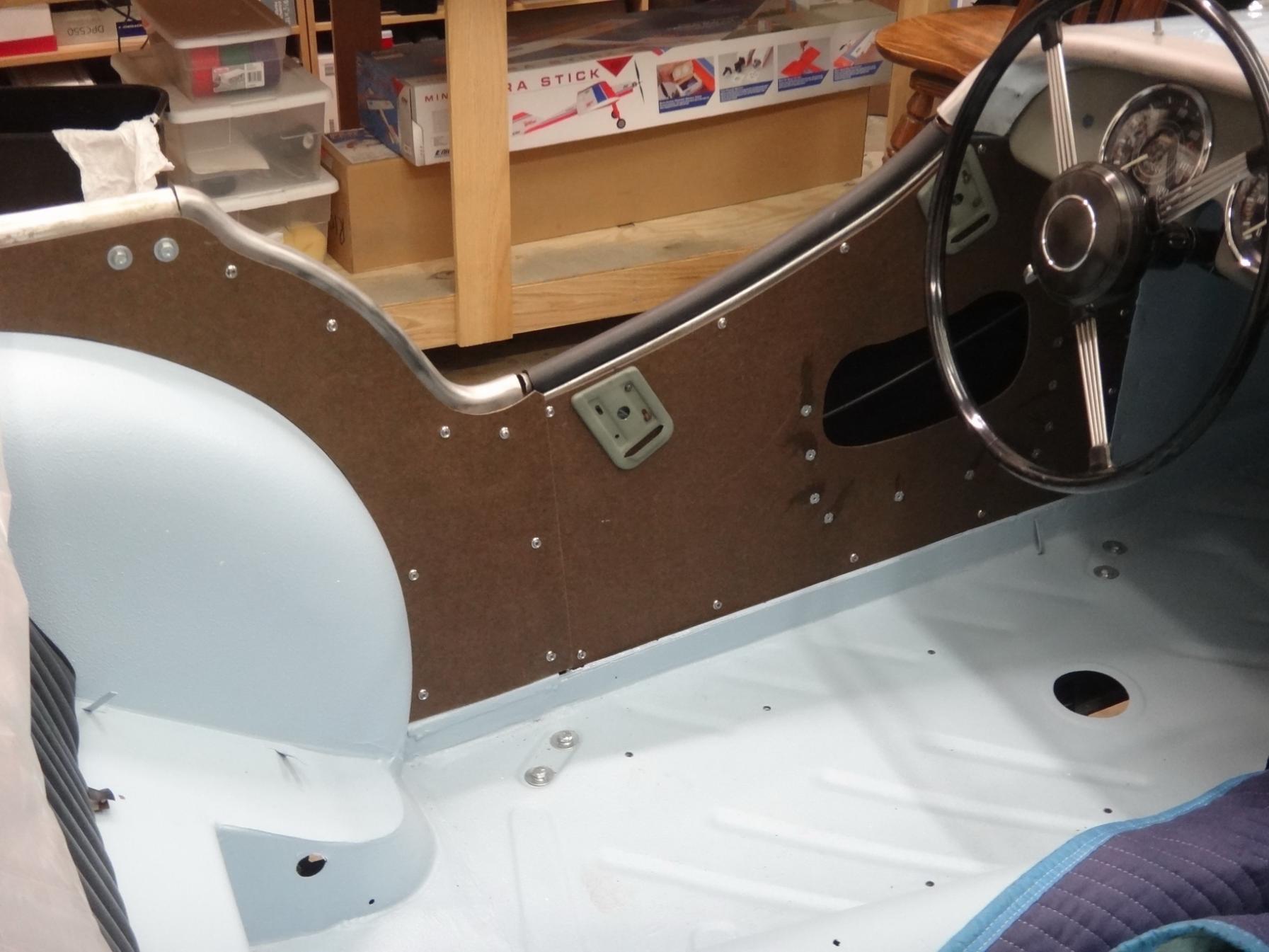

Need advice or info on attaching the kick panel carpet vertical edge and furling to the A post.
Are interior trim screws used same as door panels? If so about how many?
Also cant find any pics of dogleg panel screw locations.Any pics appreciated,post 60k car .

I recently finished reconstructing all of the interior panels on a pre-60k 59 TR-3a. Here's a photo of the left side panels that shows the screw locations. I had the old panels to help locate the holes in the body, but in the end, I drilled some new holes in the panel and the body to get clean holes in the body. It proved to be easier that way than trying to hit the old holes straight on at several points.
