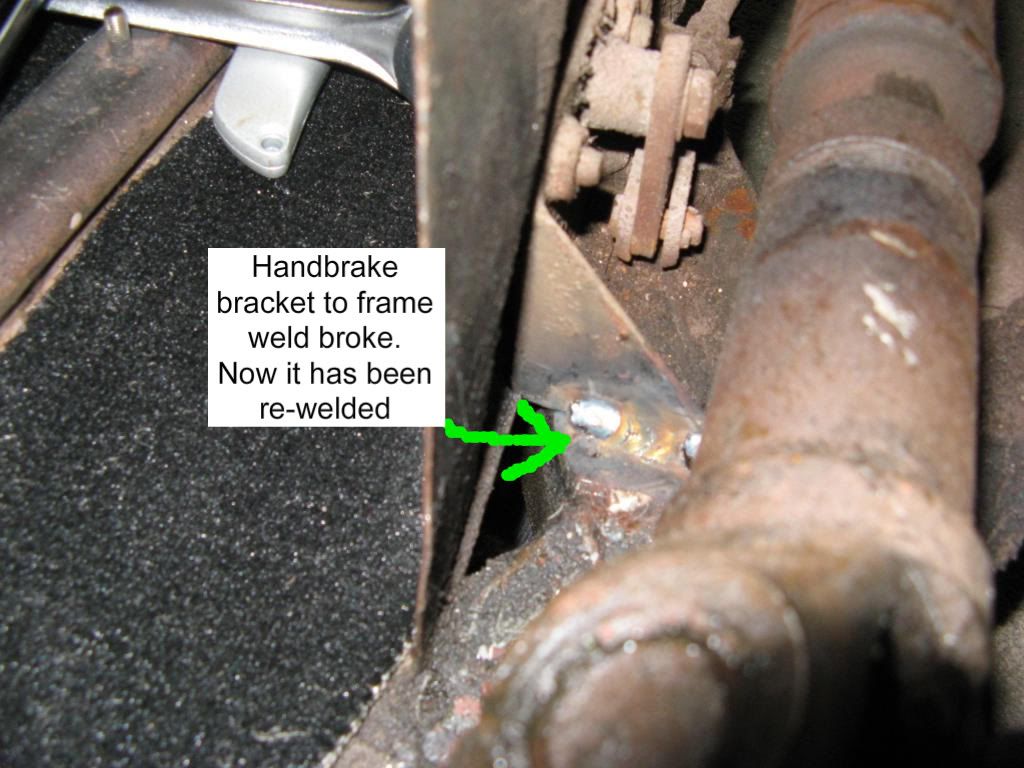

If you disconnect the rear brake cable at the rear of the car it's easier to come out in total, after you remove those two screws. Look carefully at the Moss catalog photos of the E brake if you don't have a shop manual. It really isn't that hard to do. Most likely you'll find the bracket holding the cable under the tunnel (the cable just slips in the slot on the bracket) has broken its weld and will need to be re-welded.

This is the bracket that needs to be welded if the handle wobbles around.
but you would have to remove the tunnel to see it and fix it if needed, so while it's off, it would make the carpeting job much easier.
