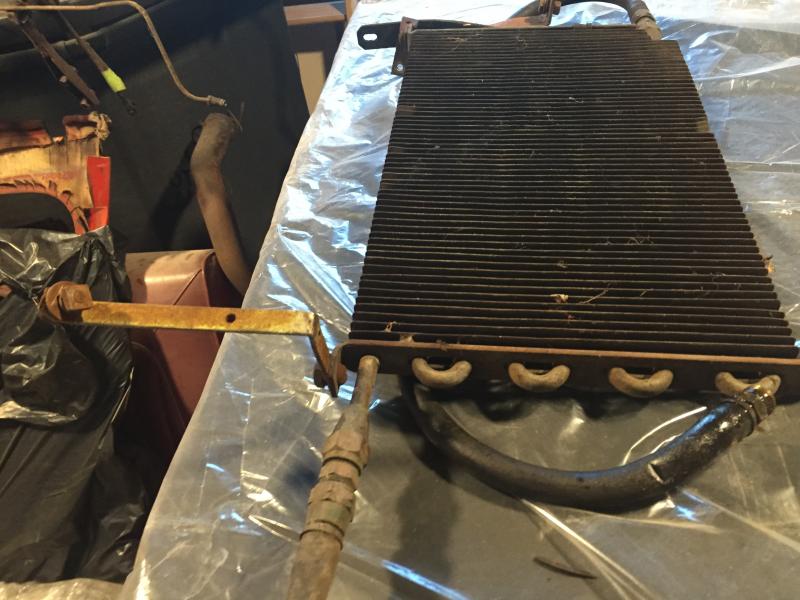

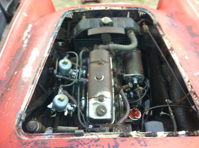

I have a friend who is doing a frame up restoration on a 1956 BN2. The car came with an oil cooler that I had never seen before. It was mounted on the distributor side of the engine (not easy to see in the old picture). Has anyone seen an oil cooler like this or know anything about it? There are no markings that we can find. Seems like an odd location.

That was my first impression as well. It doesn't look like other engine oil coolers that Ive seen. An A/C condenser would have more fins (I think), but it could also be some sort of industrial heat exchanger.
I guess it is providing more surface area for cooling, but its orientation surely isn't optimal. Jim
That looks very similar to the power steering fluid cooler from an Infiniti G35. I never knew such things existed until the one on my wife's car started leaking.
Sure looks like a homemade contraption to me.
Somebody took a transmission cooler off an old car and adapted it to the Healey.

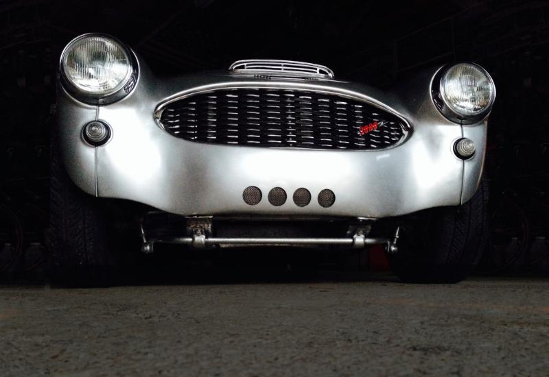

Not the most efficient location but if nothing else it allowed the owner to carry an extra couple quarts of oil. I used the conventional location with a slightly larger cooler and adapters from Denis Welch and #12 AN fittings from Russell.
I also added a shroud to help funnel the air.
I drilled the holes with a 2" hole saw and covered the back with Stainless Steel 304 Mesh #8 .035 Wire screen to keep the big bugs out and glued it on with GOOP adhesive. It's been there for 15 years!
