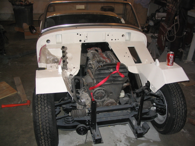

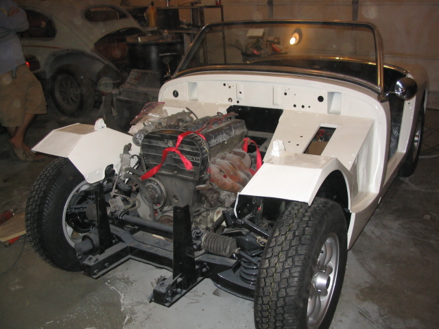

I'm using the Samurai 5 sp. Bolts right up. Besure to get the metal plate that goes between the block and the transmission. The starter needs it for alignment. Use the Samurai clutch also. I think there is a Toyota 90 deg. conversion that works.
There is one more clearance issue not discussed. The thermostat housing also comes out the back. This is more of a problem than the dizzy. I'll try to get a picture up tomorrow.
