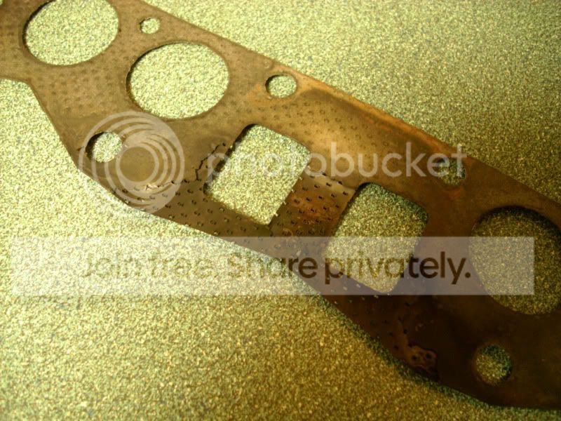

The reason I ask is that I've just replaced the head gasket and although I was careful in installing a new manifold gasket, I seem to have an exhaust leak there. I did forget to re-install the single bolt that connects the two manifolds so I was thinking that may have something to do with it but now it seems that is a red herring.
I'll put in another gasket following the method you mention from the TR3 manual.

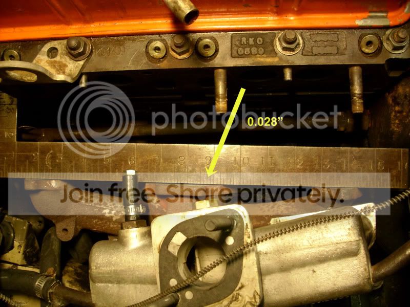

Looks like Randall nailed it:

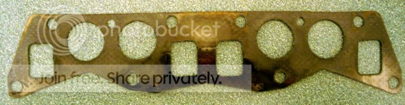

The new gasket is 44 thou - is it worth trying or should I just pull the manifold and take it to the machine shop for skimming?

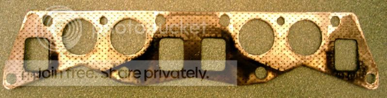

Here's the gasket that came out:

Good catch.
Personally, I would have it machined flat.

Maybe I'm missing something ... you just tried a new gasket, which promptly failed, and you've found a huge low spot that matches exactly with the gasket failure.
Why are you asking us ?

Well, someone still might. But that was my smart-alec way of saying I agree with Pied. No offense intended.
It goes back to the old saying that applies to how we fix things. "Just because you can do something, doesn't necessarily mean that you should do something".
I agree with Randall and Pied and I mean no offense either. It will never be right until you correct the gap issue.
