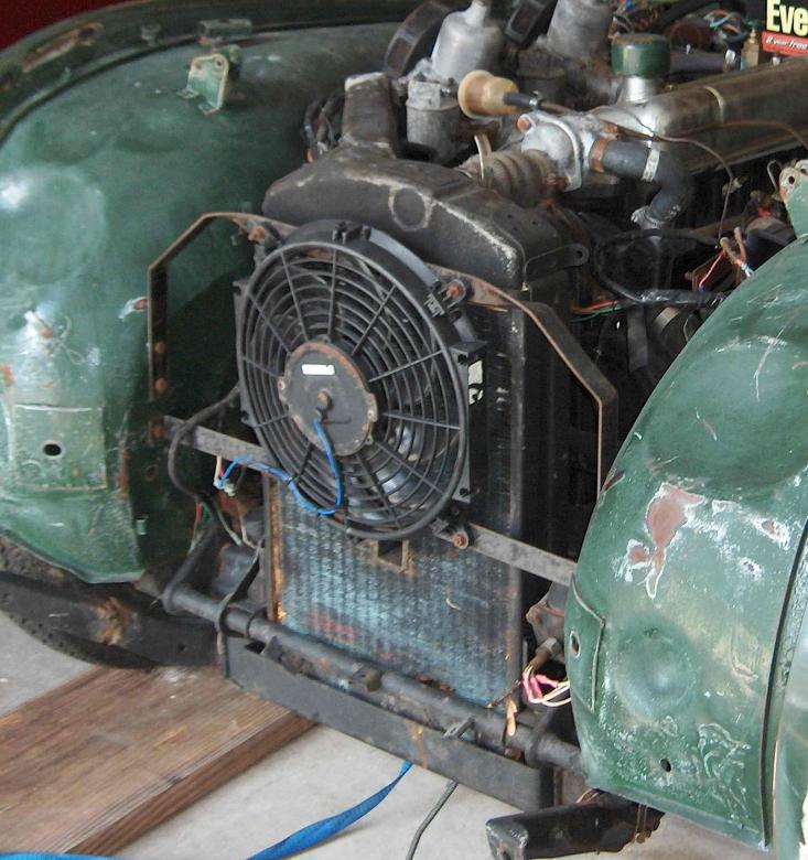

I used them for a long time on two different cars; never had a problem. Asked my radiator guy about them and he thought they were OK as well. His suggestion was to install them so they don't rub against the radiator tubes, which makes sense but may be somewhat difficult to control in practice.What are your experiences with the "through the radiator" fasteners?
this winter I installed a Hayden fan w,o removing the apron but I did remove the grill and bumper. Also used the through fasteners. Everything went very well with good results.

i got an installation kit from flaps which included a probe that pressed into the radiator, between the tubes, much like the mounting pins.
