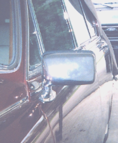

I may be in the wrong forum because I'm a Jaguar enthusiast, but I've been there done that: I installed Electric mirrors (YES) in my 1965 Jaguar S type. I got them from a modern Jaguar XJ-6 including the XJ-6 switch. Can't live without electric mirrors, especially in today's traffic conditions. It's a safety issue.

attached is a photo of the Driver's side XJ-6 electric mirror in my '65 S type. Incredibly, the XJ-6 mirror follows the door contours of the S type perfectly. Some things never change.

that's the same reason I removed the Lucas "motorcycle" mirror from my Jaguar S type, they are totally useless, not to mention their manual adjustment. But if the car is for show, then use the original mirrors. My car is for driving and enjoying, so electric mirrors are a must. I also added a Center Top Mounted Stop Lamp from a XJ-6. People get too close trying to see "what kind of car is that?" Very dangerous in today's traffic conditions. For me it's Safety First.
