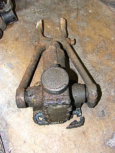

A little late, but check the mounting bolts of the shocks to the crossmember for tightness.
You don't want THIS to happen....

Not late at all. Thanks, Rick - will do!
