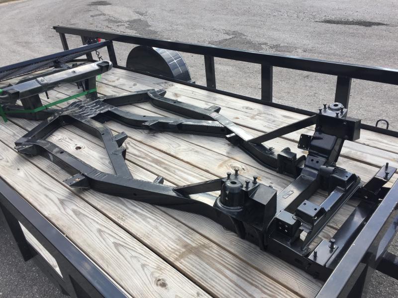

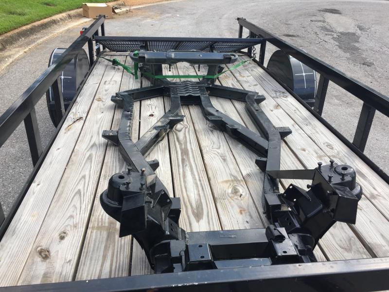

Good morning all. I picked up a restored 71 TR6 frame yesterday and other than a few storage scrapes and chips it's in great shape. I'm wondering about using any of the internal frame coatings and if it's necessary or just a good idea. I've used Eastwoods in the past on my Bugeye sills and orher known rot areas, but is it worth doing on these frames?
Thanks, Rut
