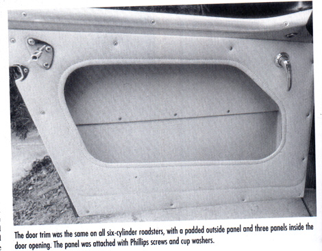

I am work on the interior parts of a MK1 BN7. when I got the car it had flat door panels, I am putting it back to stock with open outer panels and inner panel to cover the inside of the door. can some one please send me a picture of the upper panel as it relates to the door handle. I am in the proccess of cuting out the boards and cant moove forward without seeing how it works
thank you.

Hi Kevin,
Will this do? See attached - from Anderson/Moment book.
D
I made my own panels for my '59 BN6 100/6 this summer. I could trace my panels for a reference, (they have been fitted but not installed). Also, Bob from NC sent me a tracing of the outerpanel which I still have. You are welcome to them if you're interested. Bob
I guessed on the outer panel based on some pictures I have. a tracing of the upper will work great. it doesnt need to be scale. I am interested how the relief is cut for the door handle. when you made yours did you copy a factory part?
Thanks for all of the help
Kevin R
Kevin, the upper part of the top panel is buried so high up it can't be seen because of the overlap of the outer panel. The handle "notch" does not have to be exact as it is hidden. I made mine by trial and error. Make them as large as possible so they will barely fit into the opening and then fine tune the fit. Haven't tried to make the piece that lines the bottom yet, for that one I'll wait until after the other panels are mounted on the door. A word of caution, if you're going to glue vinyl on the panels, all 3M adhesive is not the same. I've use 08074, 08088, and 08090 and two of them were krap and lost their adhesiveness over time. The one I used for the dash was GREAT. I can find out which one is the good one this week- (they each came from different sources) as I need one more to finish up. Bob

It never crossed my mind that the over hang of the outer will hide the handle and relief. thanks that make things easier.
