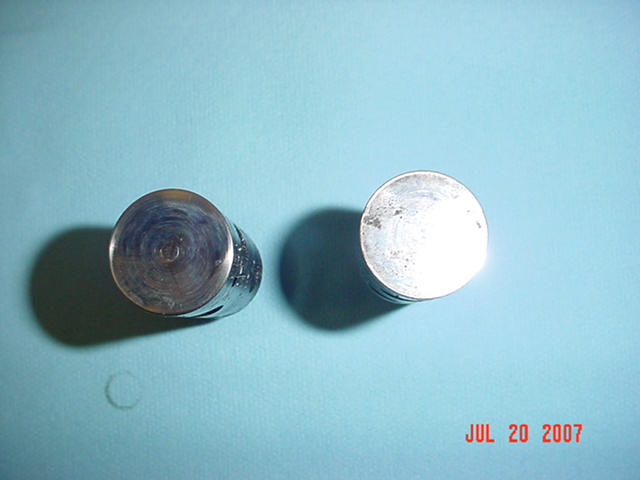

Attached is a pic of two tappets. The LH one has many miles & shows no signs of failure. Some very light circular marks due to the tappet rotating as it works which is desirable. The RH one (same mileage) shows the beginnings of failure, note the start of pitting on the face, & the beginning of failure to rotate.
Flat tappets are designed to rotate which reduces wear considerably. They rotate because 1- The tappet centers are located slightly off center of the cam lobe centers. 2- the cam lobes have a slight taper of about .002" front to back. 3- The Tappet faces are crowned about .0015". If there is enough wear in the parts to disturb this geometry the tappet will stop rotating & wear a trough on it's bottom surface.
This is why variations of .004" with a precise cam lift measurement would show that the above cam lobe taper, & or the tappet crowns have been reduced (worn). This will proceed to serious cam lobe/tappet wear & failure.
