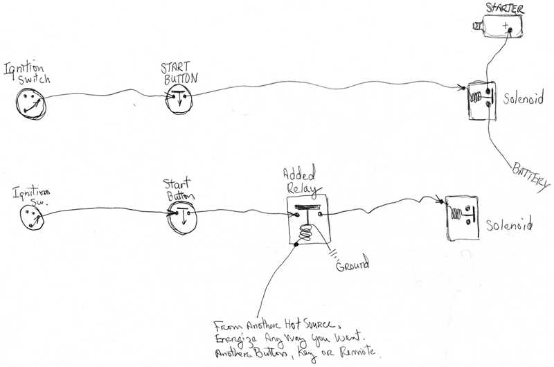

Hi everyone. With respect to everyone, there is something about this concept that I do not understand. Typically, a relay is used to close a circuit that has higher amperage and larger wires, with a circuit that has much smaller amperage and smaller wires. The low side of the relay, or the smaller amperage side of the relay only have to pull in the coil of the relay which needs less amps than the circuit attached to the high side of the relay. You can see in my attached picture that that is just what your normal starter solenoid does. It is already a lower amperage circuit coming from your ignition switch to pull in or close the high amperage circuit between the battery and the starter.
If you install a relay in the circuit between the ignition switch and the starter solenoid, you would be using ANOTHER low amperage circuit to pull in or close an existing low amperage circuit. And the ignition switch would still have to be on, and the starter button would still have to be depressed to make power over to the starter solenoid.
If you used a relay to energize the solenoid from a completely different source than the ignition switch and the existing starter button, you would actually be building a completely parallel path to get power over to the starter solenoid. You would still have to turn the ignition switch on to get power to the coil so the engine would start. I don't understand why you would want to install all the additional electrical circuitry, wires , connections, and another component (the relay) that is effect would only by-pass the starter button. If your so worried about the starter button failing, put a new one in. see attached pic. I my be missing a whole different concept here, if I am please let me know. Dave.
