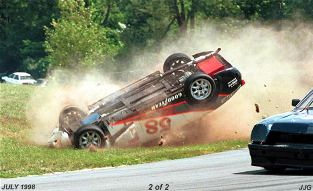

I may as well get some good out of this picture. Here's a decent shot of the exhaust on my Bugeye. If I wanted to run sans muffler, I just pulled the rear hanger, and loosened the band clamp to remove it. The I'd just reinstall the turn down, or I could add another section of tube where the muffler was.
This muffler was actually a front resonator out of a prototype 2000 Euro Market GM S-10 Blazer.
The system isn't nearly as close to the fuel cell as it looks.

Why does it say "This Space For Rent" on the bottom of the fuel cell?
It actually says. "If you can read this, I've <span style='font-size: 11pt'><span style="color: #FF0000">really</span></span> screwed up". /bcforum/images/%%GRAEMLIN_URL%%/grin.gif

Thats one way to show off a clean under carriage. If not for that who really see any handi work /bcforum/images/%%GRAEMLIN_URL%%/jester.gif
I look at that picture, and after I wince, I say "the hood sacraficed itself for the sake of the frame"
