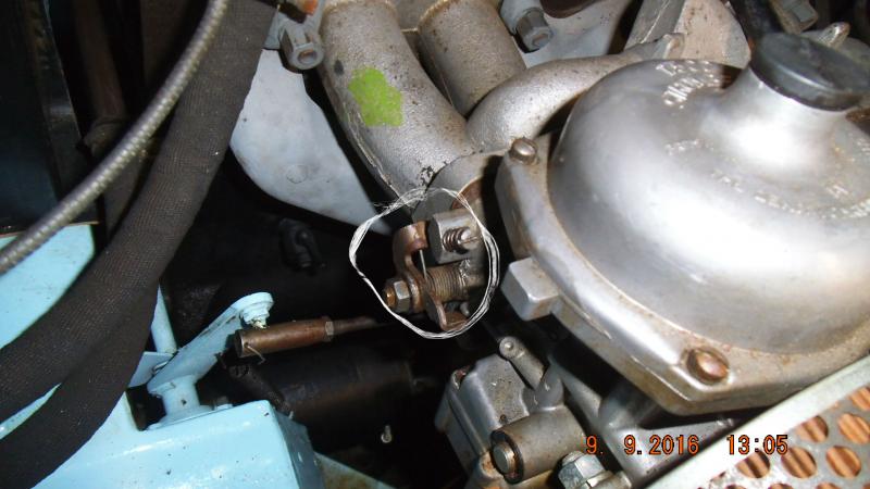

The 1964 Tr4 was idling a bit high so I looked at the screw to adjust and it did drop the idle but the return spring will not bring the metal to rest where it is suppose to...I circled in the photo... the nut etc...does anyone know how I can get this spring to rest against the bottom of the idle screw?...I tried to adjust the nut next to the spring but it will not go tight...maybe the nut is stripped?...right now with the return spring so far away from the metal bracket someone has to physically hold the part down so it rest on the idle screw because the car runs way too fast...anyway I hope the photo explains the problem and I am not babbling...Marla

Loosen the connection between the 2 carbs that joins the throttle shafts together... See if that allows the tip of idle speed screw to come to rest on the pad....That btw, is what you do when synchronizing the carbs...make them independent by loosening the throttle shaft coupling , adjust each individually until they 'balance' in sync, then reunite the throttle shafts.
The nut on the end throttle shaft has nothing to do with what you are trying to do.
:iagree:
Almost certainly the issue. Should clear it up.
I agree, except that nut is what holds the lever to the shaft. If the nut won't tighten to the shaft, you may have a problem there that needs to be addressed. Probably have to replace the throttle shaft, which is a fairly complicated operation.
The nut does tighten to the shaft...so that is one headache out of the way...thank you...Marla
