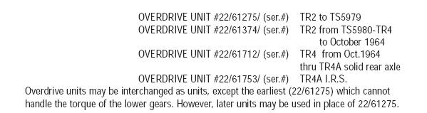

There is a chart in the Moss TR2-4 catalog, for TR2-4 OD. ISTR we've discussed that the leading digit is not always correct though, so perhaps you should only look at the last 4.
As it implies, though, all TR3 through solid axle 4A were functionally identical. The change during the TR4 run was just some internal parts, like rubber O-rings for the operating pistons instead of the earlier cast iron rings.
IRS TR4A got the small bore accumulator, to soften engagement.
