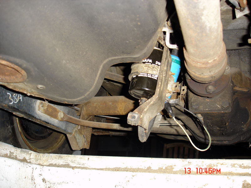

Take a look at this picture and tell me what you think the problem is (other than the dangling fuel pump wires)... I'm such a knuckle head...
Yah, I know - repairing this bracket was next on the list after the starter. But, I got so disgusted with the running, I quit with it for a while. Let's hope when I get this mount back in place, and replace what I hope is a seriously clogged fuel filter, she'll run like a top again. It's been hanging there for at least 4 weeks.
Ok...here's a long shot. Check the connections on the FI's temp sensor. My connector broke, and with a total broken connection, the injectors were just dumping fuel and the car would not even fire. If you have a bad connection, it may be holding the injectors open too long, and causing a flooding condition.
PS. The bracket definitely needed fixing though. Good thing you hadn't bottomed out on something!
