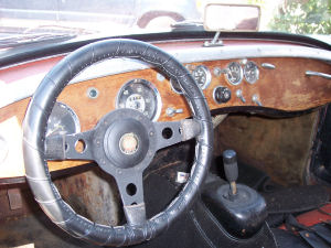

Looks nice! I like that color!! (do you have the shifter housing on the wrong way round? On the Bugeye it mounts so that the rubber grommet is horizontal!)

The shifter housing is on backwards. I actually just have it sitting there for now I still need to spray it when I get the hood and some other bits. Good catch though.
