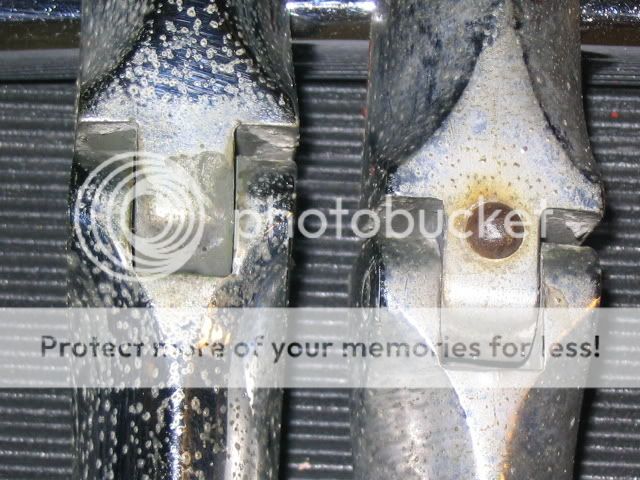

Other then the TR2 hinges being painted body color, are they different then the TR3A (from TS236xx) hinges I'll be looking for??
There was a difference in that some had little buttons on them that acted as stops, where some diden't. But I can't remember which was early and which was late. they were fully interchangable anyway so It's really a mute point unless your a judge at Pebble Beach.
Yankee. Moss does sell unplated hinges for TR2s, and they are a bit cheaper than the plated ones. But I understand your thought as I'm in the same position. I need hinges soon for panal test fitting before I pull the body off the frame, so they're probably gonna be in my next order.
Here's a pic of both types that Banjo mentioned:
I, too, would like to know if the button's for the hood or trunk lid.... just don't remember anymore....

According to the "Orig Triumph TR2/3/3A" by Bill Piggot; It says: The Bonnet & Boot hinges were painted up to "TS7228"; Chromed thereafter: They were Mfg RH & LH (don`t put these on in the wrong way; They`ll Crack & Break):
On one of the TR2 pics; It shows the "pip" (Button Stop) on the Boot but No Description & No mention relative to the Bonnet: Sorry; This is the Best I came up with! I just educated Myself a bit anyway!

I must admit that I've never seen the 'button' type...or I've just not noticed. I'll take a look at all four of my early TR's and see if I can find one with the button-type.

I actually stumbled on that while trying to find info on the button thing. Exactly what Mrv8q posted the pic of.
I remembered seeing both types, but can't remember which went to which.

I took a good look at my TR2 boot hinges and they are not broken...I was thinking of my TR3A. AND they have the little 'button' on them...first time I've seen this.
Banjo...I think I'm going to use early Ford wing bead. I do have to take a closer look at it but it's typically a rubber or fabric style...I'll check it our and give you my opinion.
Unless they have changed in the last few years, the ones I have purchased are made out of potmetal. YES fragile as he** especialy where the mounting bolts are concerned. {strip out VERY easily} And YES mount em on the wrong side and there gonna break NO doubt about it! The ones on my 56 had the buttons on both front and rear when I rescued it from the disassembly monster. Of course they were all in sad shape Broken, stripped out and what not. I have sence went through two complete sets {they seem to get "unservicable" for one reason or another. The NEW ones I recieved from Moss have no buttons. Concourse judges might cringe, but then im not building my TR to try to appease them.
