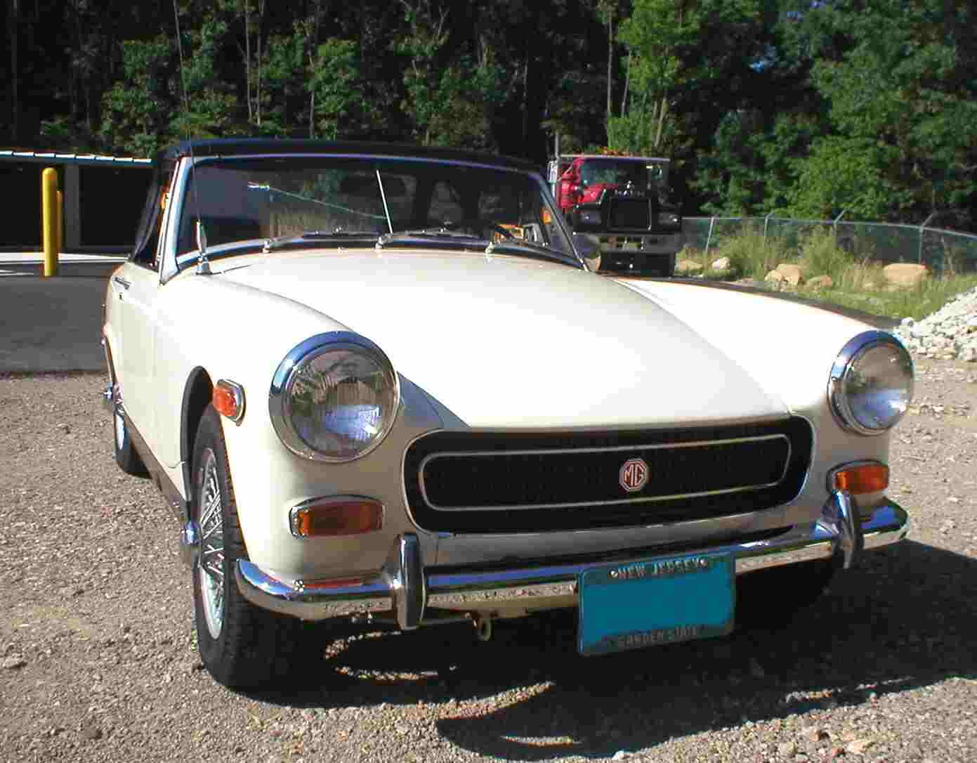

I need to see a picture of the grill surround for a 71 or similar midget or sprite. I have been piddling with the valence panel today and I started looking around in my basement and cannot locate mine and I am in no condition to hunt for it and the wife just ain't gonna do it. I'm sure its in there somewhere but for the life of me I can't think where. I need a picture or something to see how much if any overlap there is of the surround over the valence, especially on the bottom. This thing was a bit rougher than I thought.
Hopefully this will help
my 71 Midg.

There is not much overlap, but it does come out to the edge.
Remember, these cars sit low and imperfections are not as important when they are down there. (unless this is a show car)
