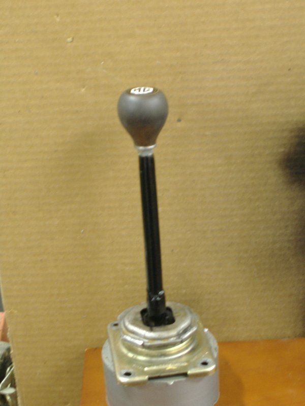

Dale, is the shift lever on the Toyota box chromed? If not then instead of modifying that MG Mitten (now that brings back memories of Sports Car Graphic magazine and such) knob and just have the correct size bolt that matchs the knob welded to the Toyota shift lever. I've done that for a couple of shift levers on T5 installations to match MG knobs and it worked fine.
Bill- that's a thought. Our concern is how far down the stick to cut. My restorer has never modified a Toyo stick & he was afraid it might be hollow and not suitable for welding. I got this one from someone on the BCF, they are no longer available from Toyo. A local machine shop may be where I end up.
