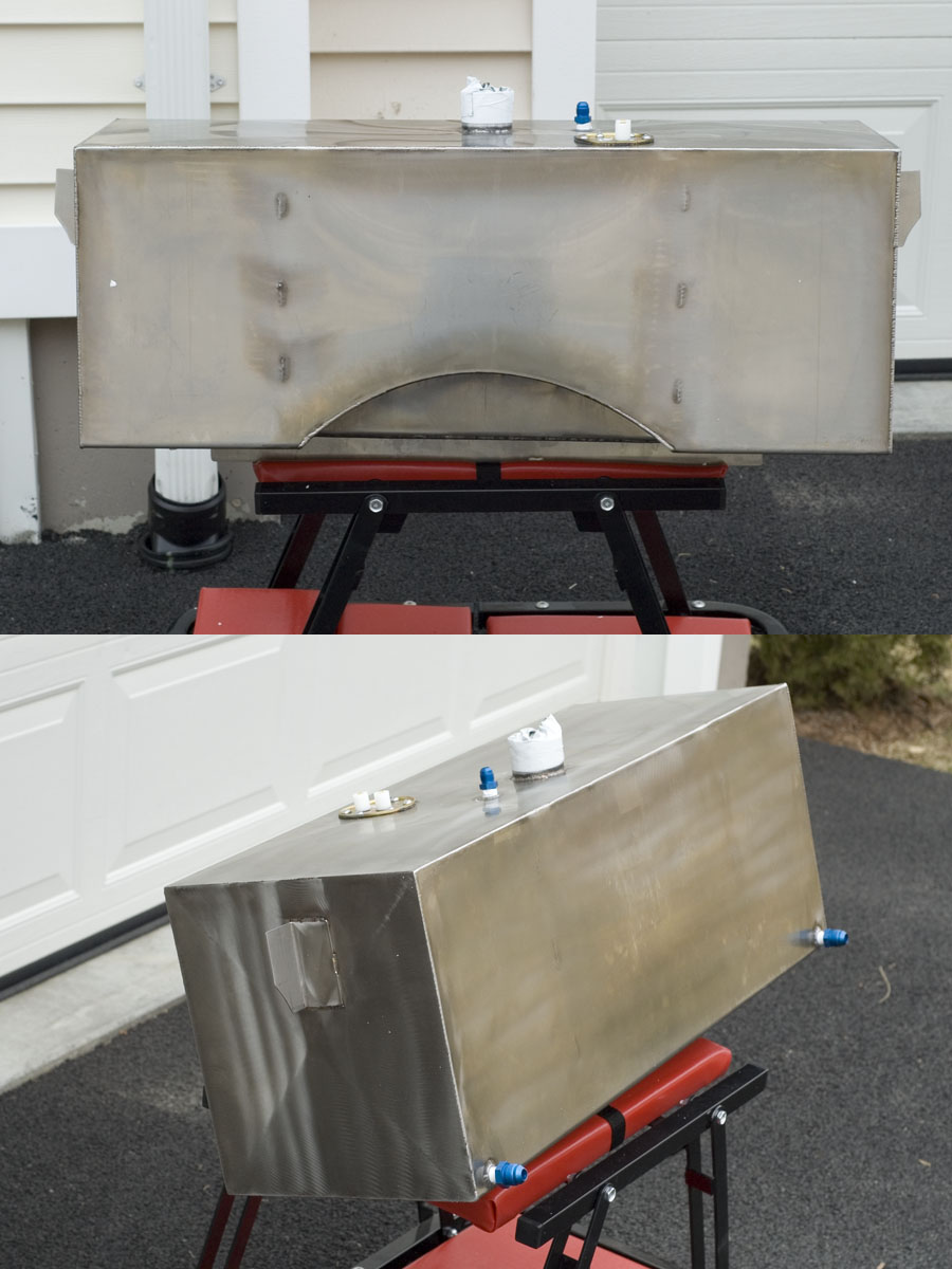

This tank is not a clone of the stock one. Its baffled and well oversize - approx 15 gallons. I modified Dan Masters' design to suit my needs, mainly by squaring it off and shrinking it a bit. I sacrificed overall capacity for installation ease.
Stock fill location, should fit in the stock mount location.
Twin AN-8 takeoffs to the rear. AN-6 return at the top plus expansion provision.
Sender is from Nisonger to mate to the stock TR6 fuel gauge, and was included.
No bladder, no foam, no sump - baffles and twin takeoff should handle the pickup. My pump is gravity fed and the system is pressurised for efi. Pump is mounted in the footwell where the spare once lived.
Cost was about $550, delivered (2-day shipping) all up. Material is stainless steel. Took less than a week to make. I tried all over to get one made locally with no luck whatsoever, so before you all say "I could have had one made for less" - I couldn't...
If you want a custom fuel cell to do the same and fit in the same location, cost was around $2500 as an fyi. That's a bit steep for me. The tank is still above the rear axle, and not out in the trunk, so it's as safe as the stock one imo.
Again, I need to see the thing to judge just how nice it is. Should be here by Friday
The end result...
Of all this. It's just what I wanted.
Thanks again to those who offered advice or suggestions.
Alan
