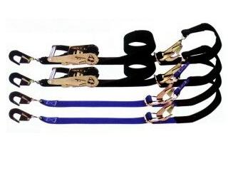

Jack and everybody else as well, here's my advice on tie downs, get really good ones, not the kind of stuff you find at Walmart, so that you don't have to worry about that cherry of yours getting loose. I see things with people tieing cars down that scares the bejeezes out of me, first off, anything with a open end hook isn't worth having, you want the safety latch ends the spring loaded closed ends, I go with 3" wide units as well. I highly recommend M&R tie downs and axle straps, go to their site and check them out.
Take this from someone who has hauled high dollar race cars thousands of miles.
https://www.mrproducts.com
