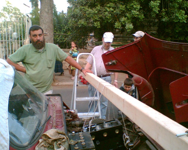

Happy to add a picture. My engine lift is not exactly the pro model! worked quite well though. One of my neighbors gave an extra hand. My father is hiding behind the bonnet.
Much more challenging was getting the engine down 3 flights of stairs! All I can say is that my next flat will be either ground floor or with an elevator.
