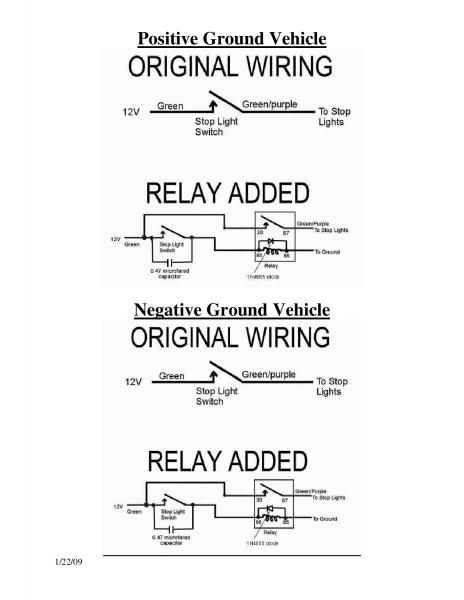

I remember one article ABrake_Light_Relay-002.jpgthat inserting a simple relay avoid the switch contacts hard works (I haven't follow this suggestion but Relay are ready in my drawer)

Adding a relay would help if the issue was point burn due high amperage draw from the light circuit. However, adding a relay would not add to switch longevity if the failure was the need for increasing peddle pressure due to a hardening diaphragm as my switch seemed to be.
