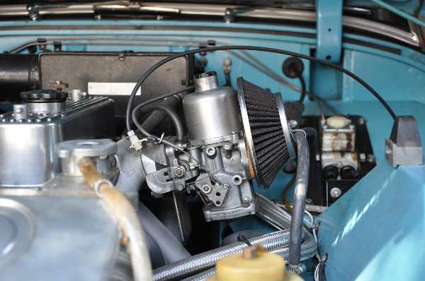

I'm getting ready to add 2xHS4s to the Sprite.
I was thinking of ordering a Colortune gizmo to
help fine tune the suckers. The carbs have been set up for my 1380cc engine but like any carb I'm sure they will need fine tuning.
14mm set? Does the thing help?
Tips, suggestions appreciated.

I never use any of the store bought tuning devices, just do it all the old fashion way, ears and eyes. First thing I would do David is pull the dashpots and pistons and record what needles you have, and then take the plunger end of a set of dial calipers and record the jet down form the bridge. At this time you will also be able to check the drop rate of the piston in the dashpots. Use that same oil in the carbs as you run in the engine, like 20/50. The biggest issue you'll have with those carbs on your engine is trying get rid of the off/on throttle bog, very common when using bigger carbs. Also worth noting is how the vacuum is pulled for the dizzy, is it manifold or port off the carb, and is it the same as what you are doing now, if you're not running a vacuum on the dizzy now, be sure to plug any vacuum sources for the dizzy on the HS4s. Now hopefully these are early solid needle, solid butterfly HS4 with no evac tubes, so if they have solid needles #5 would been the stock needle for a MGB, I guessing thecorrect neelde for your engine w/the HS4s is going to be somewhere around #2 or #3, and I would start with the jet about .050 -.060" down form the bridge. This si alot of carbs for even hot rodded street engine, so getting them lean enough will be the challenge. Have new spark plugs on hand, get NGK BP6ES, you can get them at the local parts stores. Hope this helps.

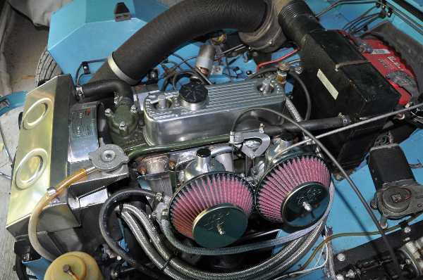

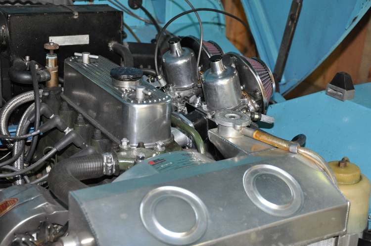

I'm getting there. Some tweaking this afternoon has made a significant improvement. New hotter plugs and more tweaking this weekend.
My needles are AAM by the way.
Re: Woo Pow!
Dialed them big ol suckers in this afternoon.
Holy Cow! Much more power. Idles at 1000 + or -
and no more sputtering at full throttle.
I love these carbs!
Funny thing is I had to enrich the carbs.
The setting that came with the carbs had the flats painted on one facet. Nice touch, btw. Yet I had to go 3 flats more in enrichment to get the wide open sputters to quit.
No off idle stumbles either.
I couldn't be more pleased.

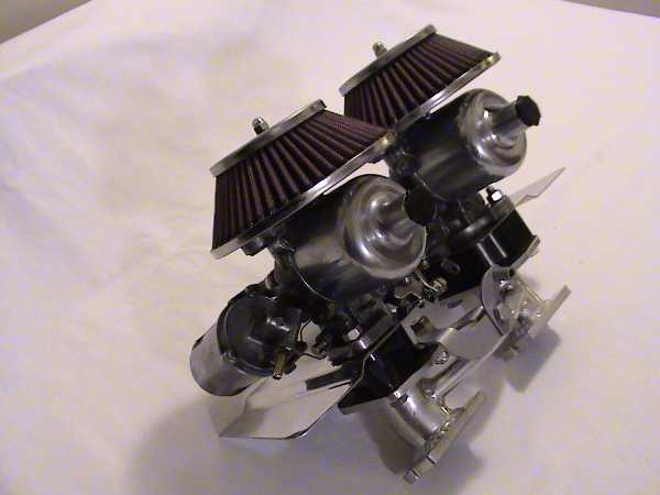

I have a heat shield between my H4's and the manifold. That is how Donald Healey's mechanics installed them on my Sprite. Is there a reason why you don't have one? I think it was a good idea. My original one developed a crack so I made a new one out of heavy sheet metal.
Re: Woo Pow!
I'm using two polished, stainless steel, heat shields.
They do sort of blend in with the other stuff.
The intake is ceramic coated. Look close and you can see
one heat shield in the pic above. Guess it's a kind of
shiny camouflage.
The wife doubted me when I was excited to get the heater tube in green. "Your motor isn't green. Isn't it aluminum or something?" I showed her the sparky side of the A as proof.
:jester:
