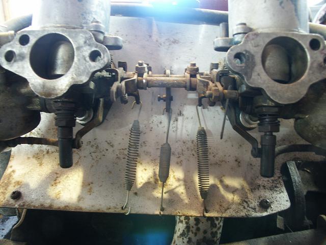

Does anyone have a good picture of an HS-2 carburetor setup they could post or e-mail to me? In particulary, I'm looking details on how the return springs connect.
Kurtis, I don't have a picture to post, but the long spring goes from the choke lever on the linkage to the center hole on the bottom of the heat shield. The two short springs are the throttle returns, and go from the cross linkage down to each of the end holes on the shield.

Thanks Jeff and Chris. I'm having a choke return problem and wanted to confirm that I had mine set up properly (which it appears I do). I think my problem is the cable itself.
