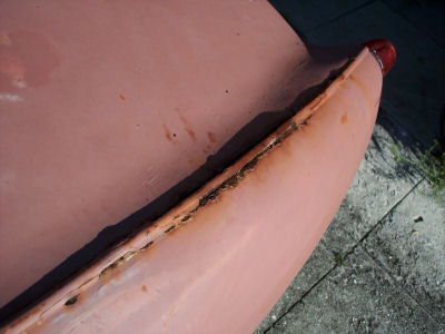

How would you deal with this?
bugimike
One picture is worth a thousand frustrations!! Remember the thread about removing the fender-bead?? Is that the answer? Will the panels eventully fall apart?

:p Now that the jokes are out of the way... That's the seam between the body tub and the rear fender on a bugeye?
-D
Honestly. I'd strip the top of the beading and sandblast and reassess if panel separation is warranted. If panel separation is warranted then I'd fill the seam some welding, and fiberglass. Enjoy the car for 5-7 years and sell it when the paint just starts to bubble.
If I had emotional attachment to the car then I guess I'd cry and separate the panel.
Whoa! That's kinda nasty!
..and I thought SWMBO's MGB beading was bad...
Fender won't fall off, but the rust mites won't stop either. Big holes and panel & bead replacement would be what come next, IMO.
Vee out the seam, use a rust converter dowm in the seam, seal the seam. Weld a 2" strip of metal over the seam or fill the seam with brazing. Bondo til it looks nice.
This worked for me on a Bugeye nose and still lookd perfect when I sold it 10 years later.
I like the sound of that the best so far! /bcforum/images/%%GRAEMLIN_URL%%/wink.gif No DNOs in the future! I will watch it crumble first and find a new tub for the good bits!(still rather inactively looking for that new tub!)

You may need to come up here and look at Herself's B... the rusted bead was an issue. The 'before' pix are MIA at the moment, but here's the "after":
I would run some straps from the inside to hold the panels in position and grind out the bead. Weld a new bead in. I know that you can get the front beads.
Both the "suppliers" carry it in "bulk" lengths, 5' pieces IIRC.
There you go Mike. It will take a bit of welding and grinding to get it right. Seal it from the back and then smooth out.
It's more time consuming than expensive, but what isn't on these old lumps?! /bcforum/images/%%GRAEMLIN_URL%%/wink.gif

Sheesh!! I never even thought to look for the beading as a replacement part!! Even at those "higher-priced" places it is quite inexpensive! I assume that it is all welded in?

bugimike said:
Brian, I do not have the Porter book! Can you give a brief outline of his method?
I can try. He chisels out the old bead, and cleans any rust out with a 1/4" drill bit (like a router) then he fills in the gap and strengthens the joint with braze and solders only the top strip of the new bead over this joint (he cuts off the bottom part of the "T" with a hacksaw). Looks like it would work.
