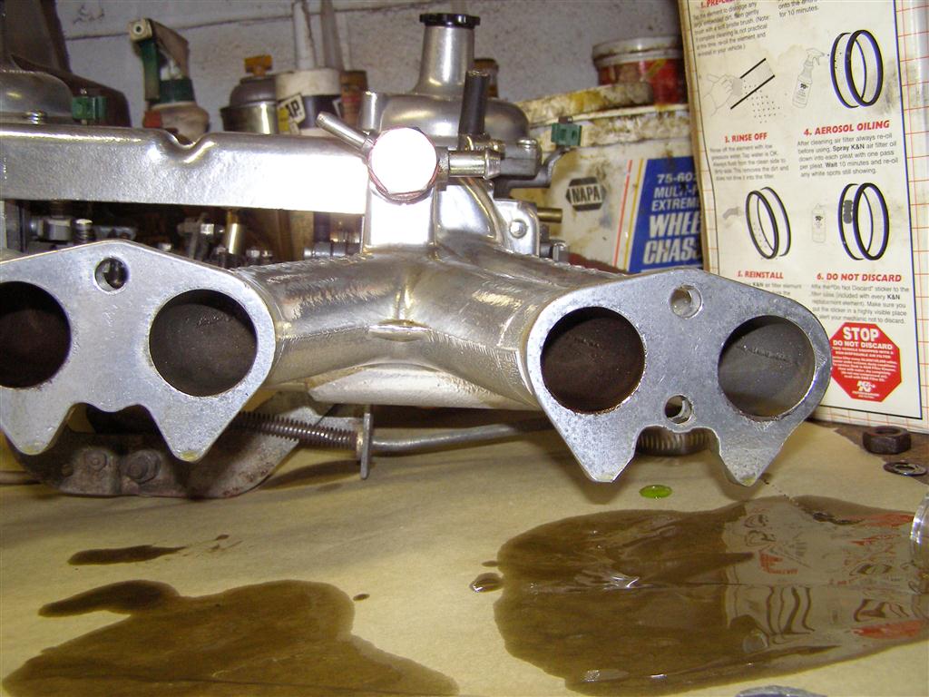

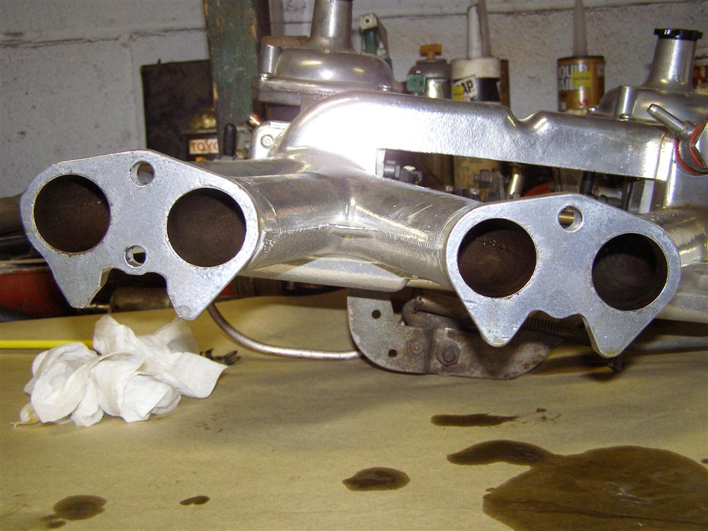

This is why most people who install them on TR6's end up removing them, especially of you use an alloy valve cover with no internal baffle. That, along with worn guides (as explained above) will put more oil into the cylinders than you would ever want.
This is what comes out of an intake after oil line and alloy cover is used for a month:

Wow..... That is a lot of oil.
I went from using a quart every 900-1,000 miles (54,000 mile engine at the time) to using a quart every 300 miles. There is the proof of where it was going.
There was more in the front two ports, I just missed taking a picture of those after they drained out.
