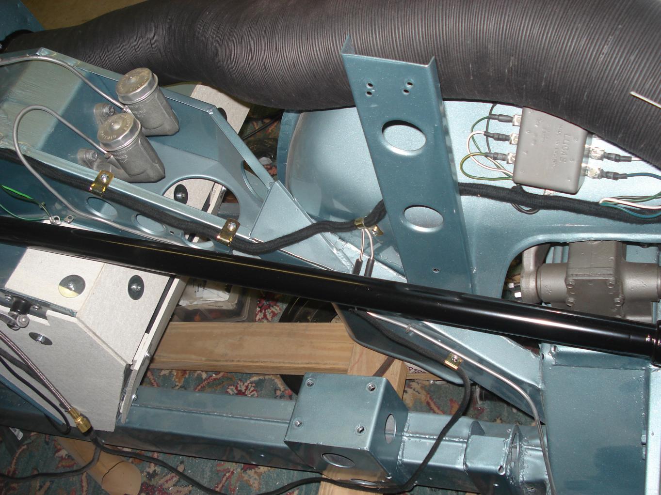

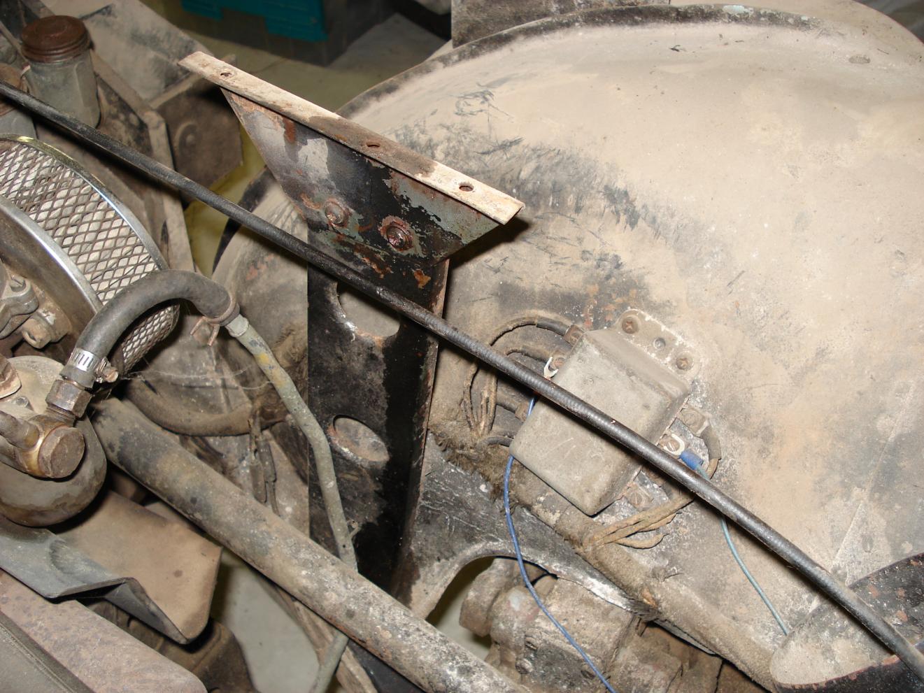

Oops, would have helped if I read it more closely, did say left side and the brake light switch is on the right side ! Call it a senior moment ! Nice looking before and after shot BTW - looks beautiful !

The box in my restored picture is the new solid state box but with the old original cover restored and put on the new box.
