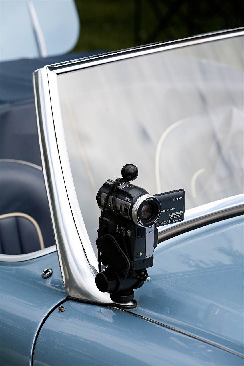

Hi Roger,
This doesn't help you since this is a BN7 or BT7, but I came across it while looking at some photos someone had take at Conclave 2007 ( I think Al Malin). Interesting idea! It might help others.
Lin
