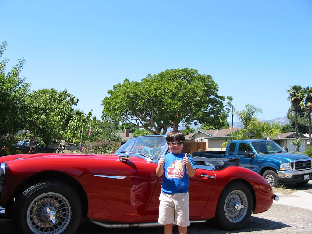

Keoke- Thanks for the confirmation. The grill is now correct and I now can drive with pride again. Here's a pic a Little Bruiser and the Brute.

Hi TH:
The formulation was a success! Eternal youth!
No, seriously the only experimentation done here was to successfully post a pic. The little bruiser in the pic is my Nephew, Jacob, taken in Santa Barbara about two years ago when he was 5 years old and just minutes after arriving for a quick weekend visit with the family.

Gonzo:
Sure hope you have re-hung the exhaust system. /ubbthreads/images/graemlins/confused.gif /ubbthreads/images/graemlins/nonono.gif /ubbthreads/images/graemlins/hammer.gif
