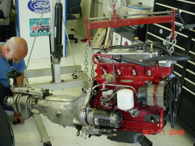

The "funny round thing"...is it on the tail of the transmission and look like the one in the photo that I've attached? That is the O/D unit. A non-O/D transmission would continue the taper all the way down to the drive shaft.
There are two switches on the top of the transmission ... the one on the driver (left) side is the O/D switch, the one on the passenger (right) side is the reversing light switch.
HTH

I crawled under the B and looked at the Trans. It is definitely an OD unit. Says right on it Raylock Overdrive. I am happy, happy. Now to figure out the wiring (after Tony's list of course. /ubbthreads/images/graemlins/lol.gif
